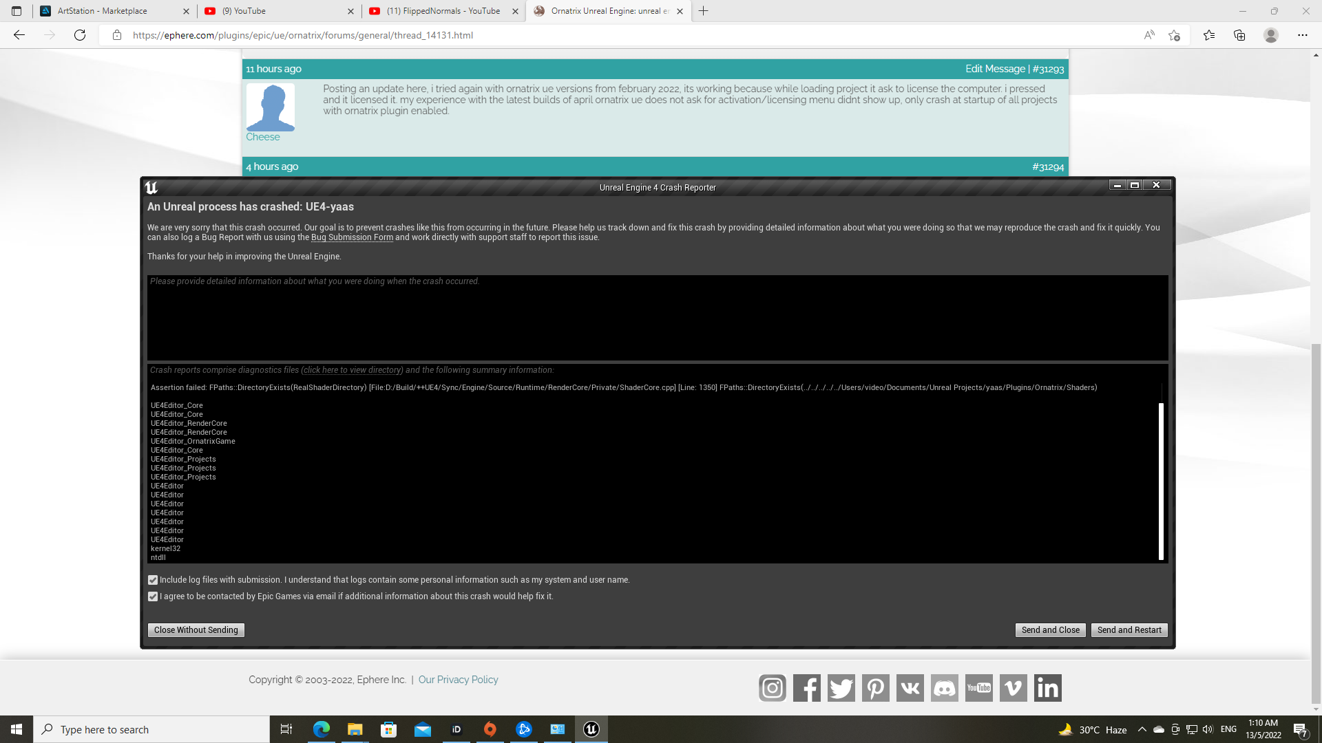

| Hi, The port to Unreal Engine 5 is not ready yet but is comming. About the crash, please share a screenshot of the crash report. Did you try with the latest nightly build? Jeordanis Figuereo (Product Designer. EPHERE Inc.) |
| ok this is the screenshot, tried with nightlybuild released 8 hours ago same problem. i have also uninstalled and reinstall unreal engine 4.27.2 and create all my project files on the same drive that is C: drive and still having problem. Attached Files:.png) |
| Someone else reported this on FB and is confirmed to be fixed in the latest nightly nuild(From 23 hours ago). Please try that one. Jeordanis Figuereo (Product Designer. EPHERE Inc.) |
| Looks good, it ask for licensing, and then unreal engine can load with ornatrix. Much Thanks Jeordanis |
