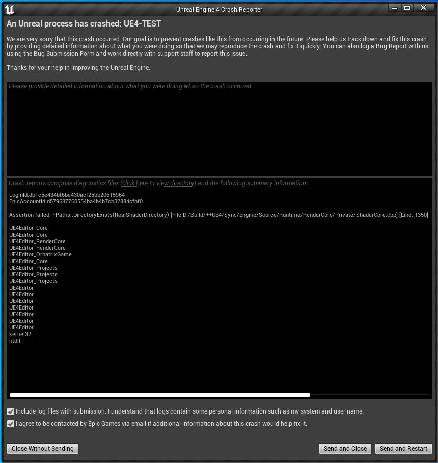

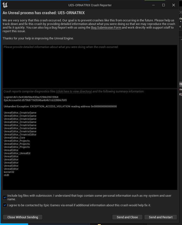

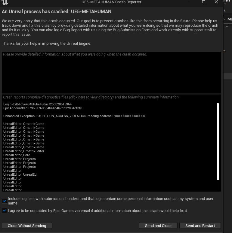

Hi there! Thank you so much for let me test this amazing hair plugin. I installed the plugin in Unreal Engine 5.02 but when I tried to start my project, Unreal suddenly did it crash. Please any suggest on this? Thanks! Steph. |
| I created a clean new project and the same issue. |
| Hi, Thank you for the log. We are looking in this. I will get back to you soon. Jeordanis Figuereo (Product Designer. EPHERE Inc.) |
| Hi Jeordanis. If you need any additional information, please let me know. On the other hand, today I tried to use the version for UE4.27.2 and the same error it shows up. Best Regards! steph |

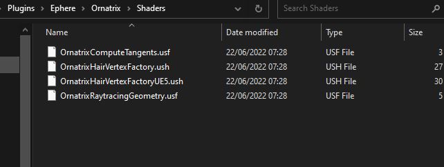

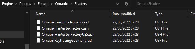

| Please check if the "Shaders" directory is in this location: Program Files\Epic Games\UE_5.0\Engine\Plugins\Ephere\Ornatrix\Shaders and if it contains any files. Jeordanis Figuereo (Product Designer. EPHERE Inc.) |
| Hi Jeordanis. It contains 4 files. Pic uploaded. All the best! Steph |
| Thanks. Jeordanis Figuereo (Product Designer. EPHERE Inc.) |

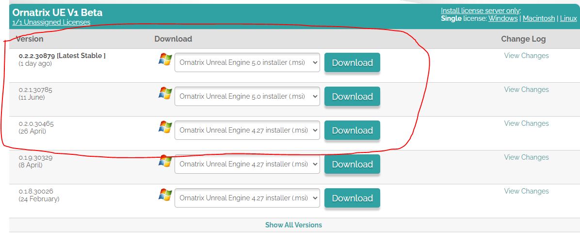

| This issue should be fixed in the latest nightly build. Please give it a try. https://ephere.com/plugins/epic/ue/ornatrix/downloads.html Jeordanis Figuereo (Product Designer. EPHERE Inc.) |

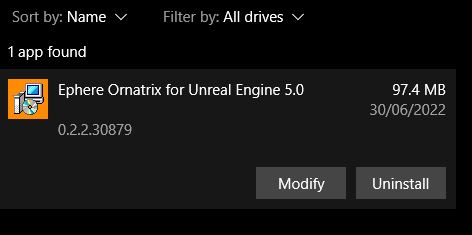

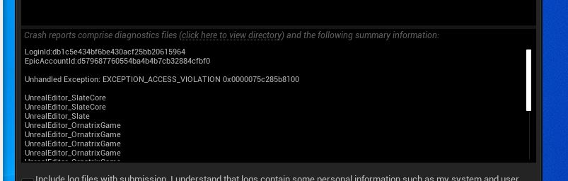

| Hi Jeordanis. Sorry, I think the same error.  |
| You need to download the latest nightly build. screen1.jpg shows the older build. Jeordanis Figuereo (Product Designer. EPHERE Inc.) |

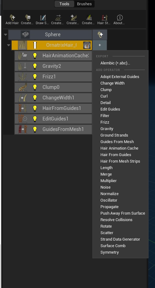

| Hi Jeordanis. I've installed the right version and UE5 does not crash anymore . But I can't find the ornatrix icon on shelf. I think the online docs refer only to UE4. |
| It's in the Editor Modes:
| Thanks !! |

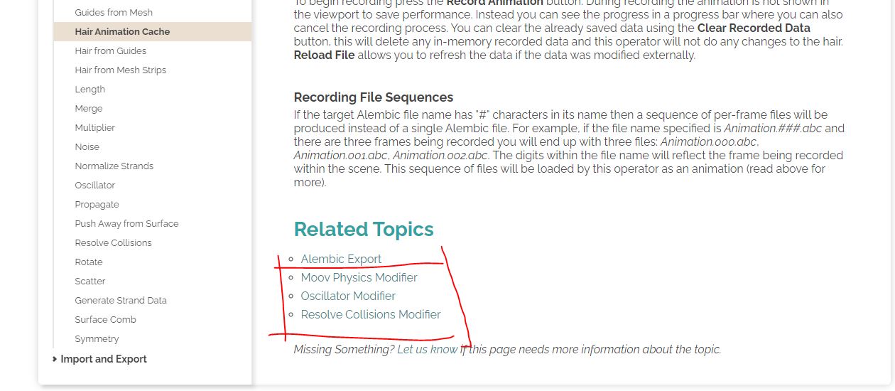

| Hello again Jordan. Please I have a question. Documents on the website refer to the "Moov Physics Modifier" option as a way to make hair animations. Ornatrix UE5 does not have this option available? If true, how can I use UE5's native hair physics? On the other hand, how could I use Hair Animation Cache if Ornatrix UE5 couldn't create its own simulations or this operator works with native Unreal simulations as well. Sorry for so many questions Regards! Steph |
| Moov Physics is not available for UE. For UE you should convert the hair to native UE Groom and animate it using the native hair physics system. This is what Epic Games recommends. Here you can see how to convert it to native groom. Jeordanis Figuereo (Product Designer. EPHERE Inc.) |
