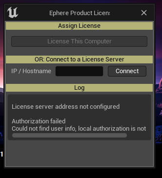

Hello, I try license Ornatrix (demo version) in UE 5.0.3, but can`t. I do step by step like in Installing tuts, in window Ephere Product Licensing button License This Computer is not activ. I try write 127.0.0.1 (also try hostname my PC) to connect to a license server, bud this not work. Help me please, what I do wrong? Attached Files: 1.PNG

| Hi guys, You cannot license the demo version. You have to log in into your account and download the commercial version. If all goes well, it will be licensed automatically. Let me know if that is nnot the case. Note: Uninstall the demo first. Edit: I get it now. The demo is asking you for a license. We are looking into it. I will get back to you soon. Jeordanis Figuereo (Product Designer. EPHERE Inc.) |

| Please try the new demo build. Should be fixed now. Jeordanis Figuereo (Product Designer. EPHERE Inc.) |

| Thank`s all work! @frankhorseshoe download 1.0.0.31293 (29 August) this is update install file. |

| My bad, is not a new build, is the same install file updated. @frankhorseshoe you have to re-download it. Jeordanis Figuereo (Product Designer. EPHERE Inc.) |
| Hi Ornatix team, i also run into the same problem. I can't license the demo, this is the Log:
191872 2022-08-31T10:44:16 ERROR: [Authorizer OrnatrixUE] TryConnect: failed: No connection could be made because the target machine actively refused it 127.0.0.1:39373
I checked windows defender, firewall and sophos, there are no activities, errors or warnings :( Do i need a full version for e.g Maya? My team is testing out different pipelines for hair/fur and we would really like to try it out. Cheers Marek |

| The latest nightly build (1.0.0.31340 Nightly (5 September)) fixed this issue. Did you try it? Jeordanis Figuereo (Product Designer. EPHERE Inc.) |

| You can download 1.0.1 which just came out, it has the fix Marsel Khadiyev (Software Developer, EPHERE Inc.) |
