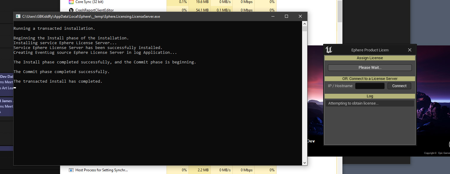

I get what looks like a succesful license server install (image attached)... Then I get this message:
Attempting to obtain license...
Please wait, licensing in progress...
Downloading https://ephere.com/licenseServer.3DF8B87E3395DAD7F3B9BB37D07E4B4AA476BB38.35362034203432303031.GBWWSLDNWS263`Microsoft Windows NT 6.2.9200.0.1.zip
Extracting zip
Installing license server
Process returned exit code 1
Would my work VPN cause a problem?
In this case, there might be something blocking the connection to the license server. First, make sure that your antivirus or firewall are not blocking the Ephere License Server, then release your license in Account -> My Licenses. Try to load the plugin again. Also, when installing the plugin, make sure that UE is not running.
