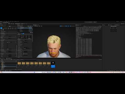

Hey, @Chanveda
Hm, everything is ok on my side. Just change hair width in native hair settings. or before creating the new hair, add ChangeWidth and play with it settings. I think your hair is just very thin after converting.
So, I recorded a video and prepared an Unreal project for you. Please test again in this project. If everything will be ok. Please share your project and I will test again. Btw, before that please uninstall all Ornatrix versions in Control Panel and install again the latest stable version.
kfgrYAKAg8M
Timing:
0:00 - Selecting hair and converting to Ornatrix
0:11 - Adding edit guides for editing. Hiding unnecessary objects
0:29 - Selecting Create Brush and drawing hair into an empty space.
0:59 - Make more hair in settings. Draw it again.
1:48 - Convert hair to standard Native Hair.
2:24 - Notice that there is the same amount of hair, just thinner.
2:49 - Go into the settings and adjust the thickness. See the same amount of hair =)
DOWNLOAD SCENE
