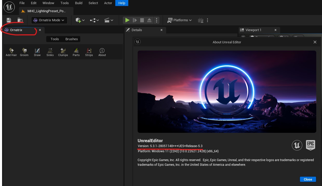

Hey. @Chanveda
Charly here again =)
If you encounter any crashes - please provide a log and steps to reproduce that crash. Or even record a video, but please, more qualitative. For example with the same Bandicam. Mostly it can be just on your side and we will deal with it.
About installing 1.0.7.33x for UE 5.3.1 - maybe your engine is not installed in the default path, then you just need to go to the folder C:\Program Files\Ephere\UE_5.3 and copy all the contents to the folder where the engine is installed.
I just tested it myself. Everything works.
I also don't understand why you don't install the latest version on UE 5.2.1? The latest is 1.0.7.3.3 too
Looking forward to your answers
Thank you and have a great day

This could be a licensing issue. Find the file OrnatrixUELicenseServerIP.txt in %LOCALAPPDATA%, or create it if it doesn't exist. Open it in a text editor, add the line "localhost" and save it.
Launch Ornatrix again and it should work.
Also, when installing Ornatrix, make sure to close UE before launching the Ornatrix installer.
