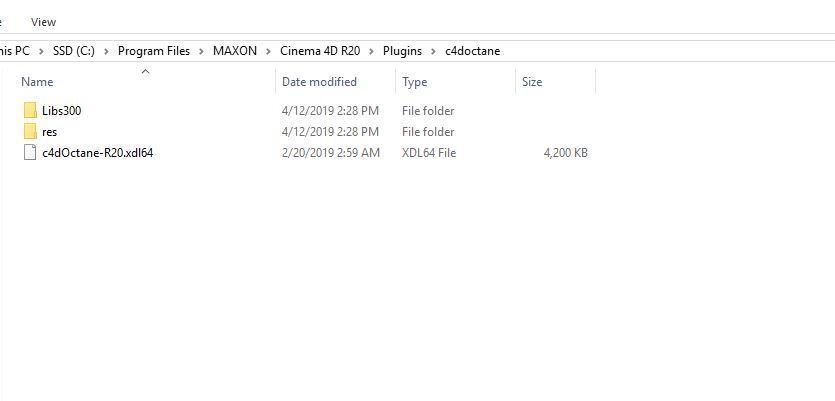

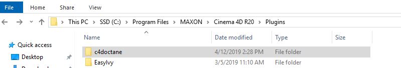

Here is the installation guide https://help.otoy.com/hc/en-us/articles/214137323-OctaneRender-for-CINEMA-4D-Installation-Guide | |

Yes, I followed the instructions correctly. In fact, manually installed plugins don;t work for me.
