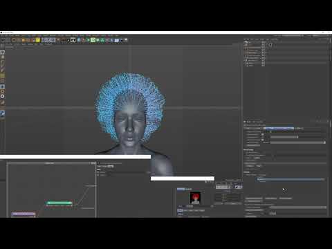

Thank you for posting this important detail. None of this was obvious from the documentation. I couldn't figure out why I couldn't control the hair color at all from the Melanin settings in the Standard hair Shader till I switched from Mesh from Strands to Curves from Strands and used the Arnold Parameters tag as well. I tried following your Ornatrix C4D Arnold channel export and couldn't duplicate the results too.
Did you wach this tutorial to export the attribute channel for Arnold?
BrsNaY4DxII
