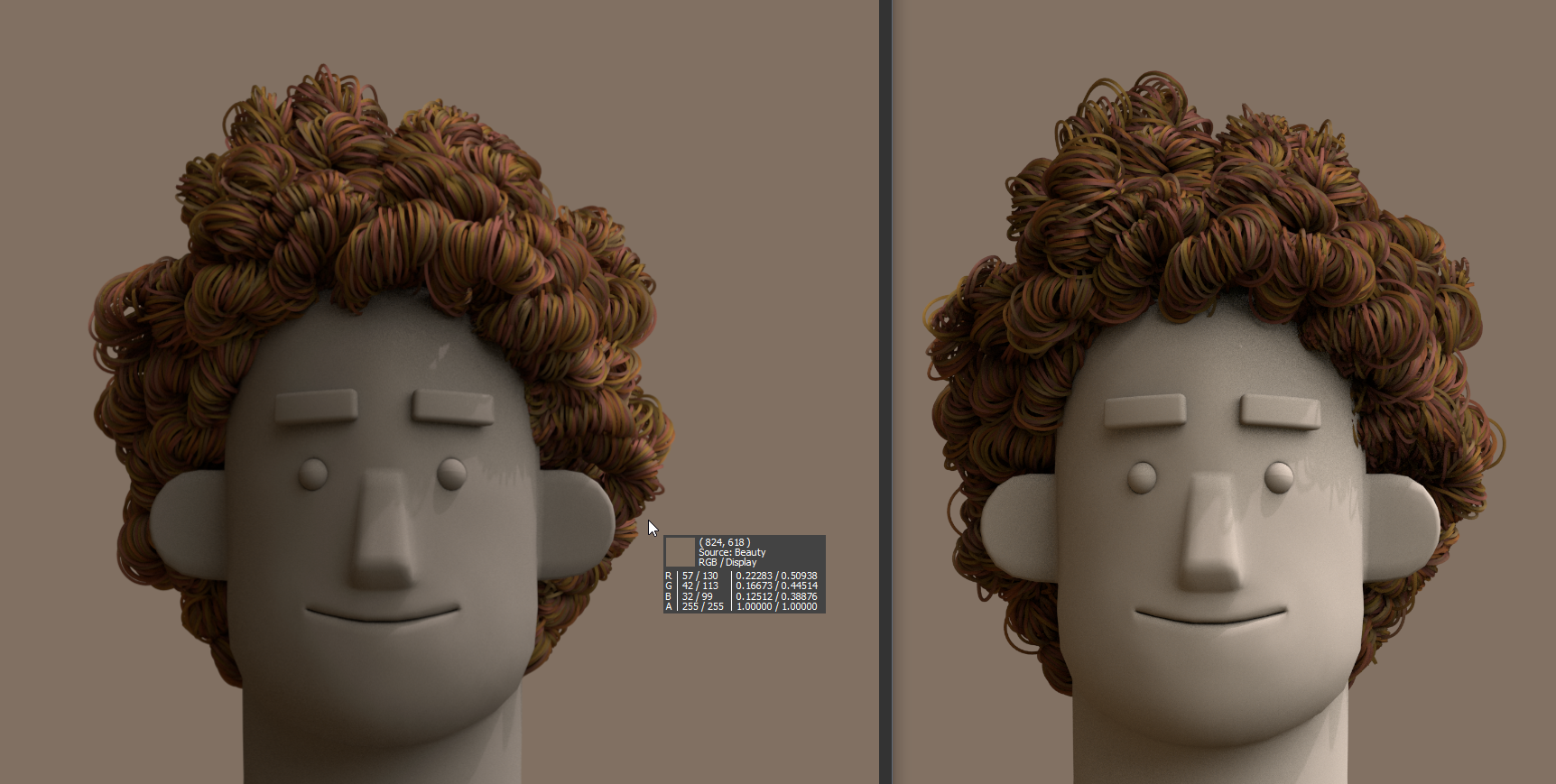

We had someone doing the grooming in Maya and then I've translated the scene into C4D, basically copied all the values. It pretty much worked but it doesn't look exactly the same. Looks like the values are not directly proportional. Is that correct? Are you aware of that?

Right> Maya; Left>C4D This is already with tweaks on the C4D side to look more like the Maya one.
Tks!
How'd you get this rubberband type of hairstyle @MarioD
Its just hair thickness.
Ohh ok thanks

I actually notice some differences between C4D and Maya as well, but it was with the hair interpolation. To test if is the same proble, turn OFF every operator above Hair From Guides and do the comparison again, please.

Yes thats what I've noticed, straight away after generating the hair from tubes the result is different.
I can send you the Maya file and the C4D file if you want.

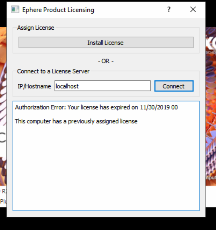

Jeordanis, we are having a big issue on our final renders. The licenses expired and we need to deliver. Is there a chance to exten them for a few days? tks!!
Sure, Done. Follow the same process as before if the licenses are not updated automatically.
