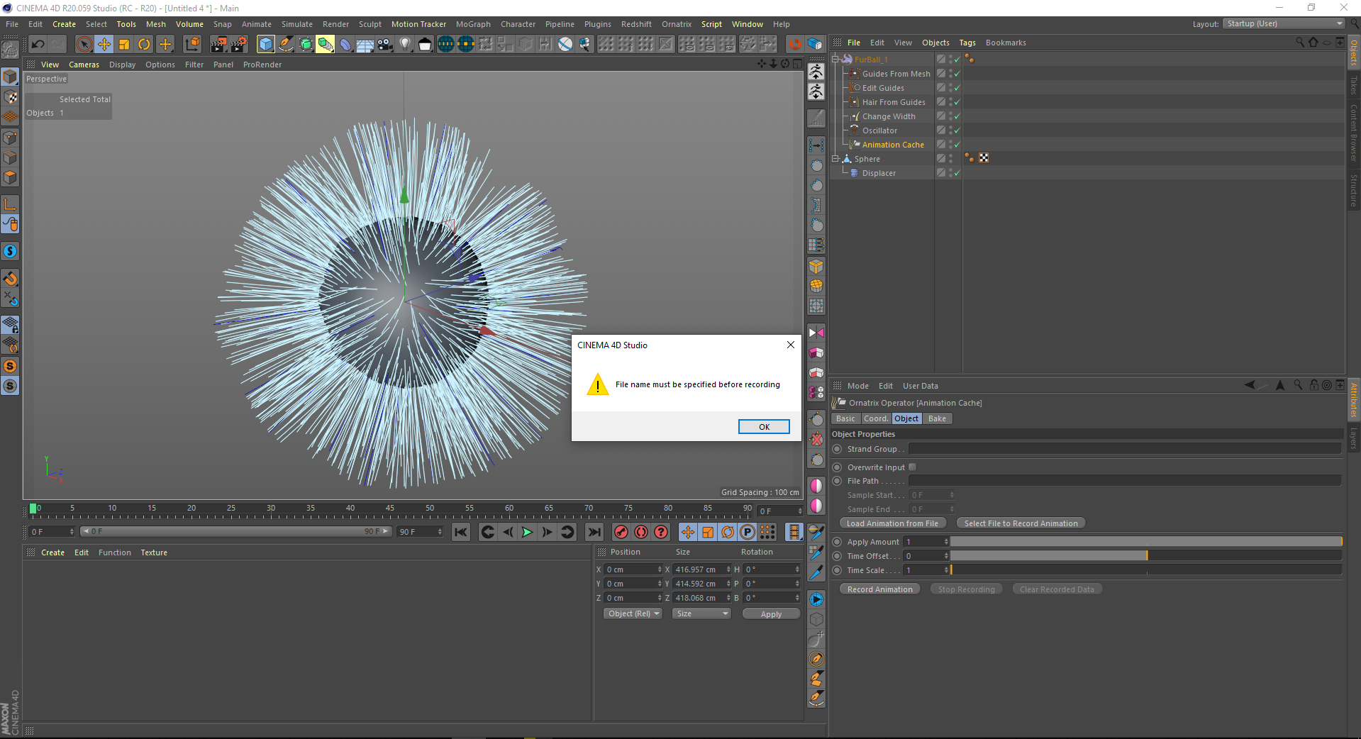

| thanks for the reply. Can you tell me what that means when I clicking record animation button? Attached Files: |
| You have to specify a file address and name for the output file in File Path, then click Record Animation. Jeordanis Figuereo (Product Designer. EPHERE Inc.) |

| Sure, no problem. Step 1: Create your animation or hair simulation:  Step 2: Add AnimationCache, enter a file name and click Record Animation:  Step 3: When the recording process ends, the recorded file will be used for animation automatically, you can remove the Moov Physics (Or whatever you are using to animate the hair) and leave Animatiion Cache. That's all.
