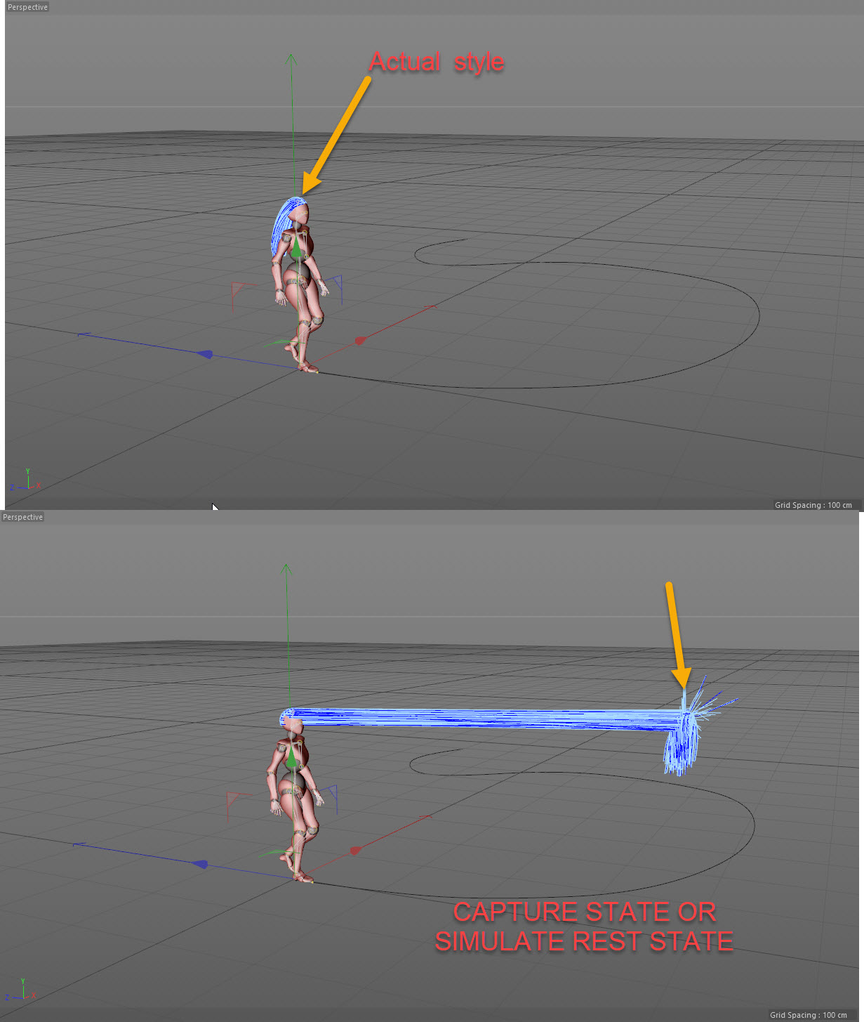

Rest state:
When I either use set rest state of simulate rest state the hair moves to the location of the last frame?

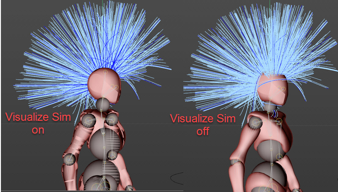

Visualizer:
When visualizer is turned on the normals of the object reverse, or I get a clipping effect in the view port?
