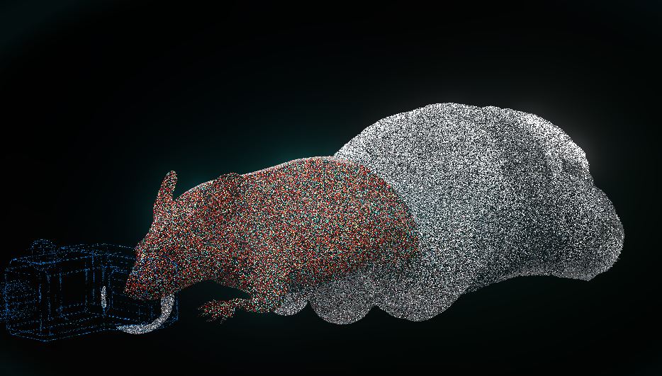

Hi, I've rendered a sequence of animated frames on our internal render farm without baking, or caching. The resulting hair is flickering as a common result. So, no surprises here... To solve this, I've tried to use the "Animation Cache" node to cache my animation from frame 40-2000. I'm trying to save a sequence of cache files to a network share using .####. in my file name. This time, I've been using the mapped drive letter, instead of the \\path to make sure this is not the reason fro the crash. But, the crash still happens at the end of the progress, when 100% is reached. Only one file gets written with 1kb, name Animation.0040.abc - which is basically the first frame. I then tried to use the Ornatrix Alembic export via the file menue instead. Using this method, all files from frame 40 to 2000 are written corectly to my shared network drive, each at about 8kb in size. Now, I tried loading this sequence with the "Animation Cache" node, but the result is offset in positive z, mirrored in the z-Direction (-1) and renderders incorrectly (huge metaballs) inside the redshift render view. What did I do wrong? How can the animation be cached correctly to be rendered without flickering, without beeing mirror and offset, and with incorrect scaling, on a render farm? Tanks, Karsten | |

The export settings dialog have options to set the up axis. Be sure to set it correctly:
Try adding ChangeWidth on top and see if this solves the rendering issue.

Yes. I've done that correctly in the first place, but double checked that after my output was wrong. I'm using the Render version, Ogawa, Frame 40-2000, NOT exporting Velocities, basically everything exactly like the screenshot you posted. As I've only one Ornatrix object, I've selected it before exporting and also DONT use "One Object per File", as this would help with splitting up several Ornatrix objects. Thanks. | |

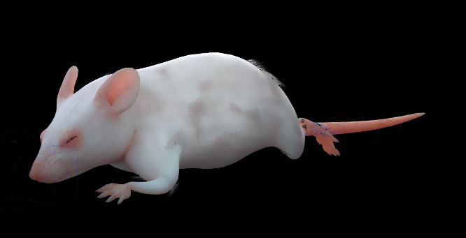

The last thing I tried:
So I loaded my .abc sequence, that is basically mirrored in Z-axis and changed the order of the "ChangeWith". Unfortunatelly, the farm is giving me strange results. Have a look at the rendering "mouse_hair_in_a_few_places.JPG". The correctly looking rendering is just a local rendering of a still image in Redshift IPR with bucket mode. Any ideas? Thansk, Karsten Attached Files: ![]() ![]() ![]() ![]() | |

So, I finally went back to an older version of my scene file (created with ornatrix 2.0.4), that was never opened and resaved in 2.0.5 or 1.0.8. I did the stack swapping trick by putting "Change Width" after "Animation Cache". Seems like the latest file got corrupted when resaving with different plugin versions.
Solution: Now, everything renders perfectly on the render farm without errors. (Export .abc as file sequence to shared network drive, loading it back in with "Animation Cache" object and reordering "Change Width".) Not working: I deactivated the "Animation Cache" und just turned ON Remember Roots Positions in Hair from Guides with this "un"-broken .c4d file. -> The resulting renders looks flicker free, but the hair is still missing in a couple of places, it is different from the broken file, as there is more places with hair, but is is still not complete. This way of rendering also has a couple of erros: Ornatrix Error: Cannot generate 33968 hairs, because their guide dependencies are missing -- followed by redshift errors and finally a redshift crash.
