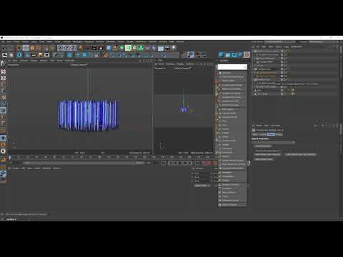

You can control Ornatrix hair using "External Guides". You can take some Maya curves and use them to control the hair. If you can somehow rig and animate the curves then you will have full control over the movement without using a hair simulation. To do this, use the Adopt External Guides operator. Find the documentation here.
如果是C4D的版本呢 也测试过使用这个功能 您发的视频本身物体是没 在移动的 那4条 导线也是 过模拟做的动画 所以 还是没能 解如何在 个高 运动的物体 做毛发的手动动画 如果 事先做好 个样条动画 转 Ornatrix的 导线 那么 导线无法拾取样条的动画
If it is the version of C4d, I have also tested the use of this feature, the video you sent is not moving objects, and the four guides are done through simulation animation. So I still don’t understand how to do a manual animation, of hair on a high-speed object, and if I do a spline animation beforehand, and turn it into an Ornatrix lead, then the lead doesn’t pick up the spline animation.

The video was to show you how to use Adopt External Guides node, but it's up to you to rig and animate the curves manually. Ornatrix doesn't provide rigging tools, only tools for hair simulation.

I'm a bit confused about what you are showing in the video but I will try my best to explain the two alternatives that you have in this case.
  • You have animated curves and you want to create hair from those curves.
           You can accomplish this by using the Hair from Curves preset. To generate hair from animated curves:
  1. select all the curves,
  2. go to Ornatrix menu,
  3. Click Add Hair
  4. Select "Hair From Curves" preset and click Generate
  • You want to animate an existing Ornatrix groom using already animated curves.
           Animated curves can be used to deform an existing groom using Adopt External Guides modifier:
  1. Convert the animated curves to an Ornatrix object like I describe in above
  2. Select T-Pose(Static) guides as reference
  3. Select the animated guides as Control Guides.
Adopt External Guides documentation:
https://ephere.com/plugins/maxon/c4d/ornatrix/docs/1/Adopt_External_Guides.html
Try any of the two methods and let me know if you have further questions.

What my video demonstrates is that when I don’t use splines to generate leads, Adopt External Guides works. When I changed the way to generate Guides at the ornatrix level in “Control Guides, ”“Reference Guides, ” to the mode of generating Guides again with splines, “Adopt External Guides” stopped working, and the original hair could not be driven.
I’m not quite sure, how to create a guide line with a spline animation, and then use Adopt External Guides to drive the hair I want, to get it going, and this is how I create it in my video. This is probably the wrong approach. I really don’t know how to create “Control Guides” and “Reference guides, ” and I’m confused.
Can you help me record a short video, or a sketch project like mine? Thank you very much!
