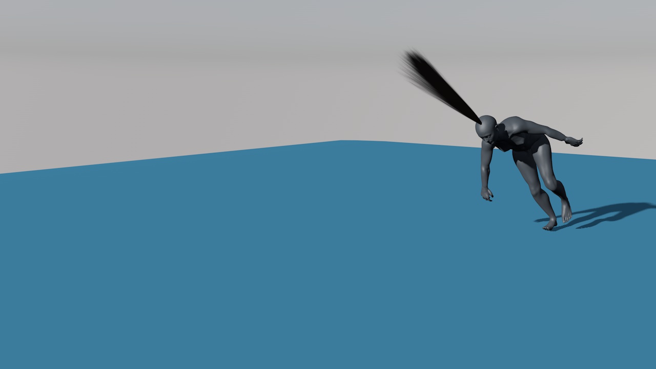

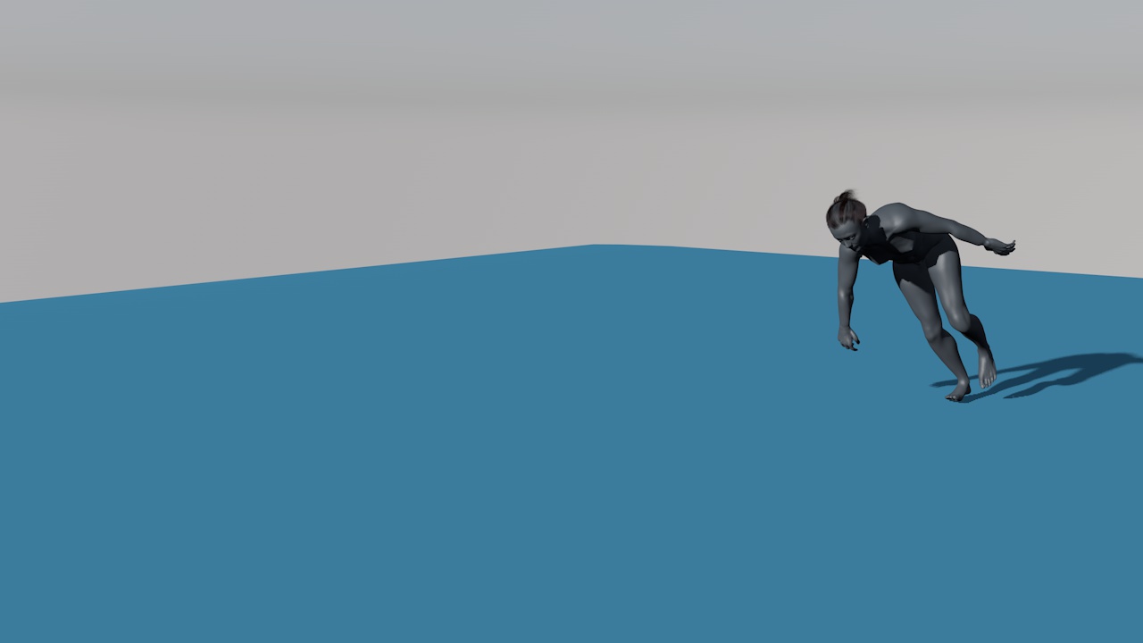

If I render the scene from frame 0, the hairs follow the geometry as they does, but if I start at frame 50 for example, It became a big mess !
Obviously, none of these shots begin at frame 0 (because of cloths dynamics and other stuffs) and sometime, I have 2 or 3 cameras with different TC in the same scene.
This issue will force me to compute hundreds of unused and useless frames.
Here is the illustration :
If render start from F0
If render start from F120 in this case

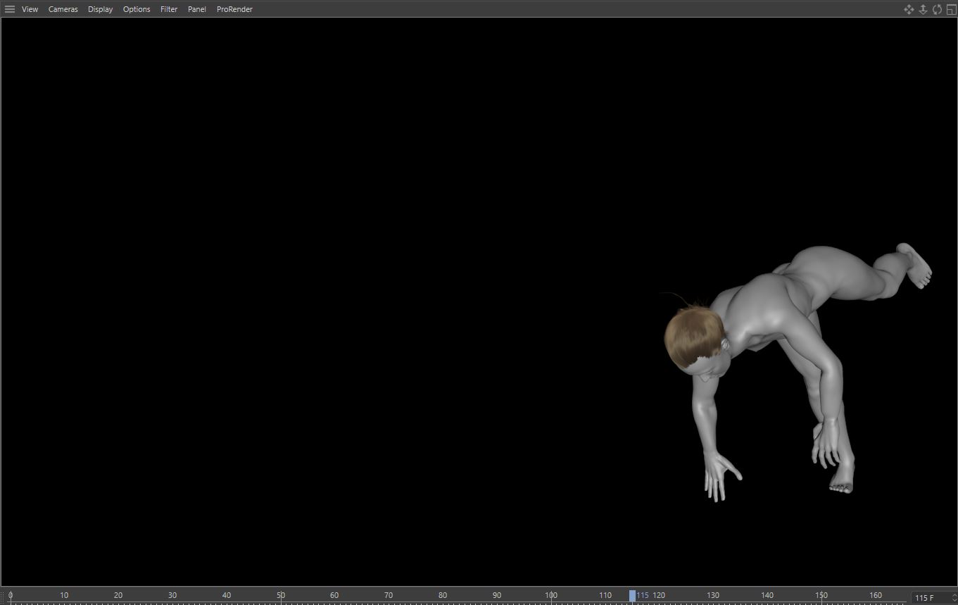

Viewport render of F115 :

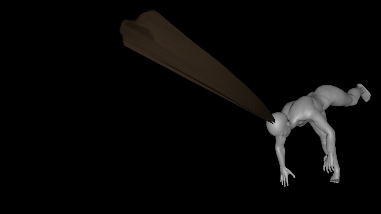

Render of F115 :
I cannot reproduce this anymore. Does it look like this in the viewport as well?
In the viewport, it looks like the first picture, everything is ok, on render, it look like the seconde one : The hairs aspect is a blend between the position at F0 and the rendered frame (F115), they are streched to reach the model root position.

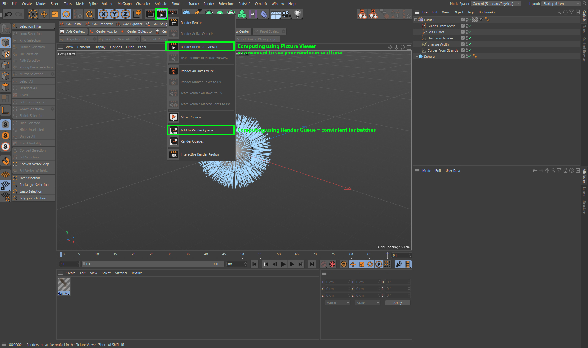

Now, I re-used this same scene but start the animation at F30, using the "Picture viewer" of C4D which is the main render tool during creation process.
The alternative is the "Render Queue", but with this last one, you can't see your render in real time, It's only designed to batch an infinite list of scenes.
An as you can see, It doesn't work.
m1PFwZLIaFE
I re-used this same scene again, and decided to compute it in the "Render Queue".
And this time, It worked !!!
izwFa7kCaok
Is it possible to correct this limitation ?
Because as I said, "Picture viewer" display your render in real-time, which is necessary when you work on the development of a scene, the  "Render Queue" doesn't ...

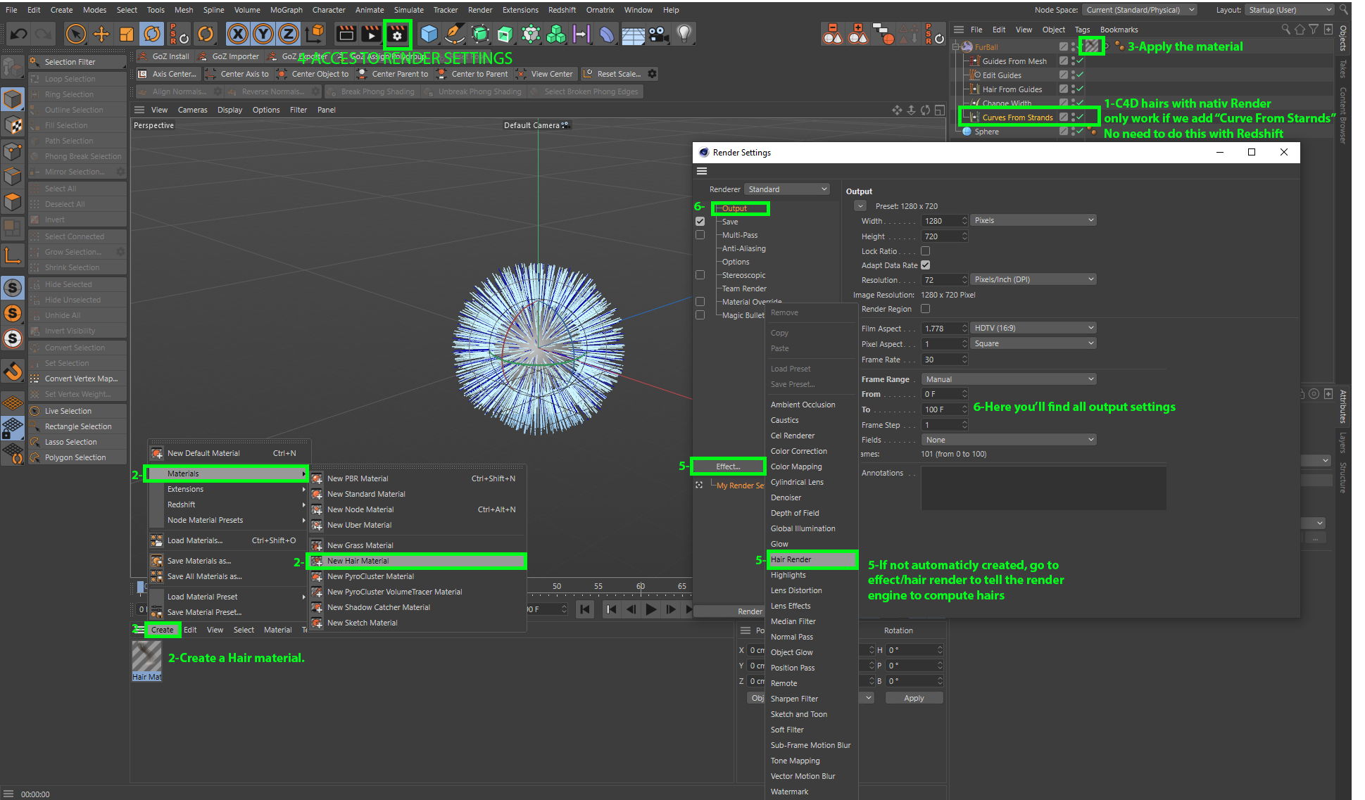

What render engine are you using and how do you get it to render the animation WITH the hair in the picture viewer? For me it doesn't render the hair and it only renders frame 100. Sorry, I'm not a C4D user.
I usually work with redshift or Arnold, but these simple tests has been made with C4D standard native render.
You'll find the process to compute hairs bellow.
1-Force C4D to Compute hairs and adjusting render parameters :
https://ephere.com/download.aspx?message=29694&f=Help-Render_Hairs.jpg
2-Access to both Rendering Methods : Picture Viewer / Render Queue.
https://ephere.com/download.aspx?message=29694&f=Help-Render_RQ_PV.jpg
