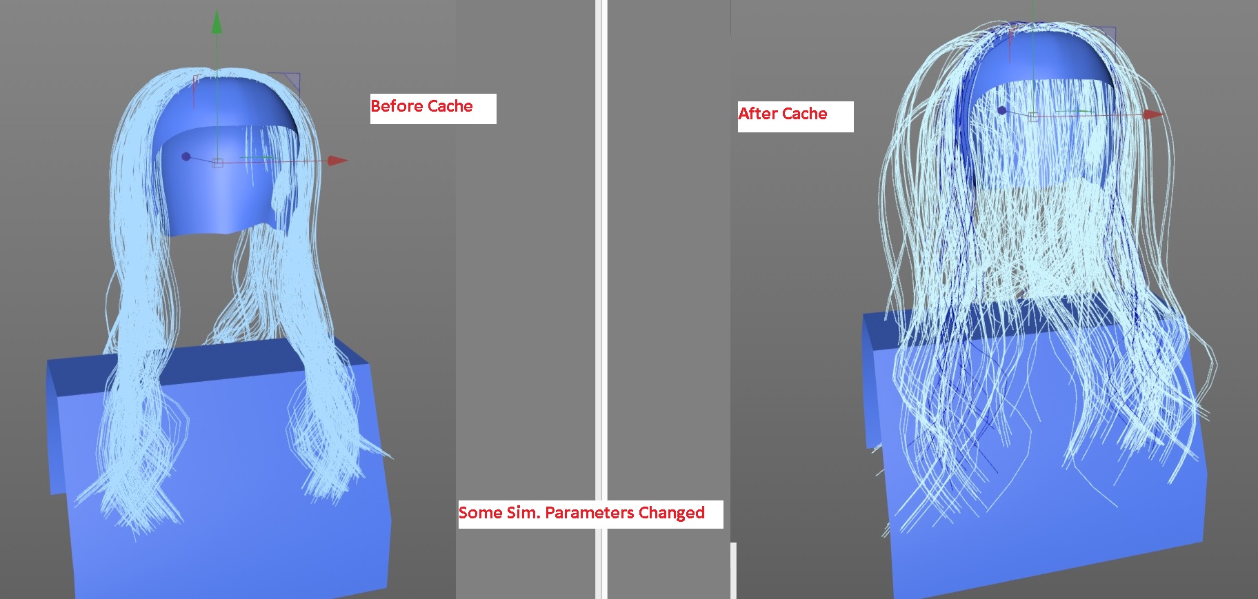

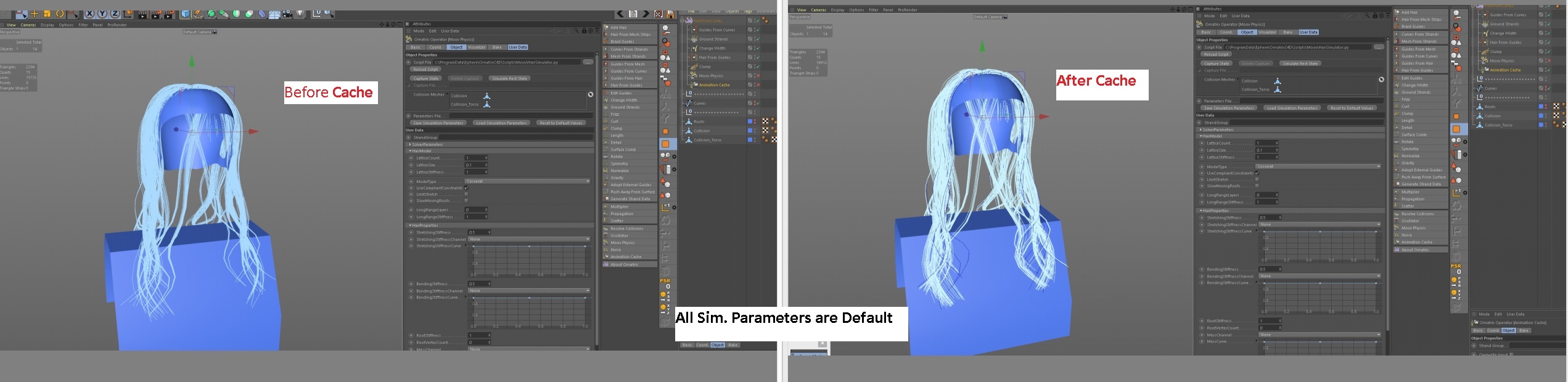

I have a simple scene with no animation, the hair falls down and collides. When I try to cache the simulation I get a different result. C4D R20 Broadcast + Ornatrix-C4D-Demo-1-0-9-25630 Am I doing something wrong? Thanks in advance. Attached Files:  |

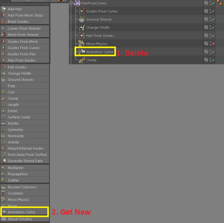

| If anyone else has the same problem: Every time before cache I get new "Animation Cache" Modifire. The result is not always the same as a simulation, but it is better. Attached Files:  |
| I think that you need to uncheck all node above animation cache node and only keep base node like guide from mesh and in animation cache node  |
| I think that you need to uncheck all node above animation cache node and only keep base node like guide from mesh and in animation cache node apply Overwrite input |

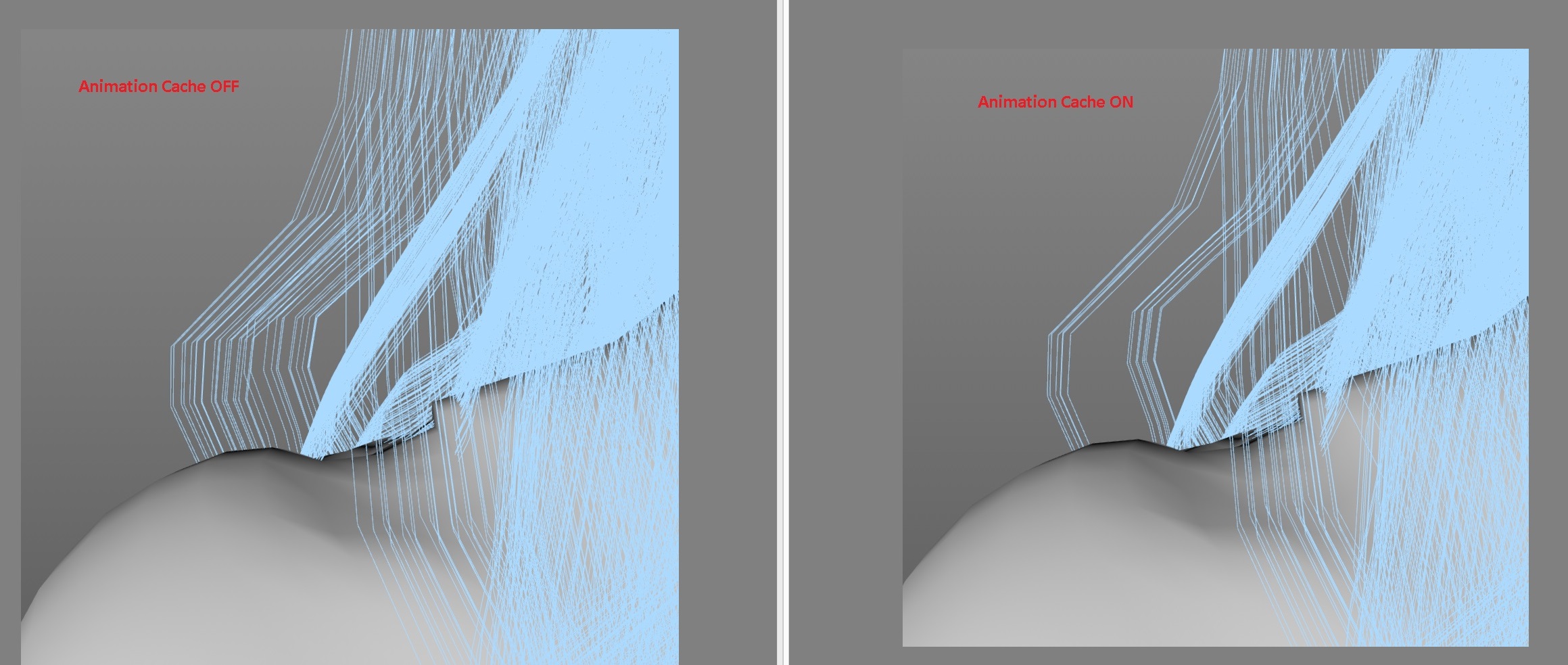

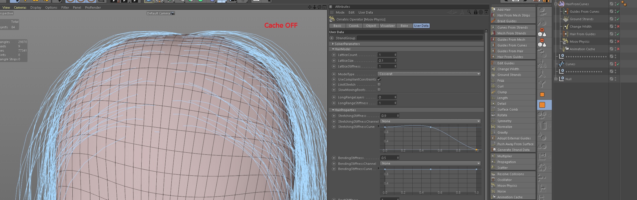

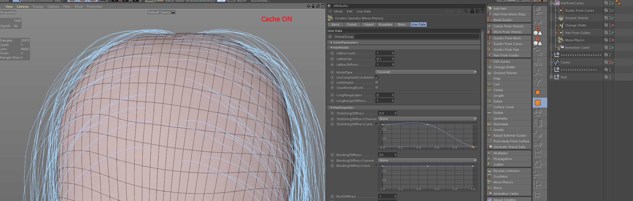

| Hello britva_27, Thank you for your help, unfortunately the only modifire I can switch off is the "Change Width" the others cannot be switched off otherwise I have no hair. I turned on the "overwrite input" but no matter what I do, I don't get the same result when caching. Thank you, all other advice is very welcome :) Attached Files:  |
