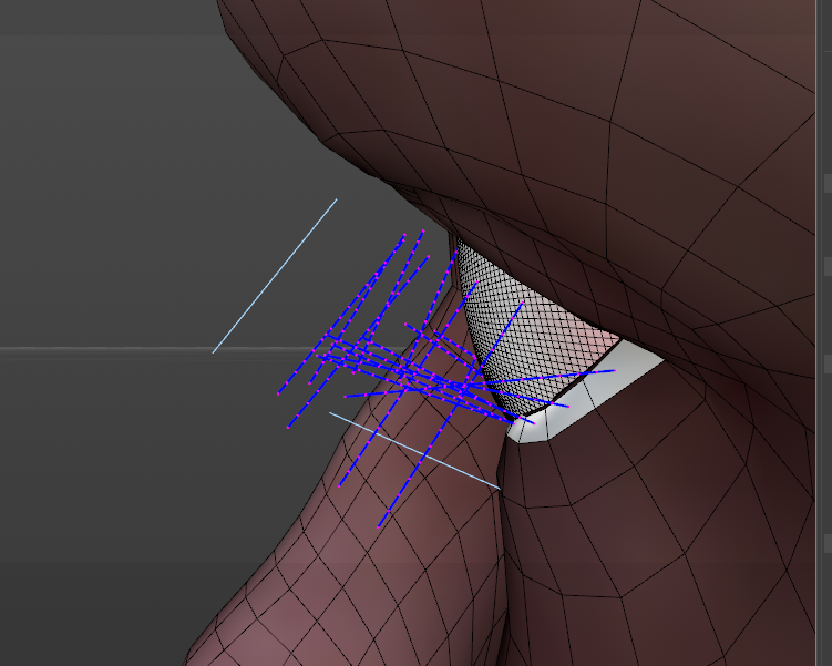

When I plant a guide to the mesh root point of guides have some shift distance from mesh
file
>Plant_guide_tool.zip (4328627 bytes),
Now I see if I delete pose0 from pose morph tag plant guide tool start to work as well
I tried with your scene and it seems to work as expected:
I'm on the latest nightly build for V2.
In 2.0.9.26055 [Nightly] works fine. Thanks for reply
