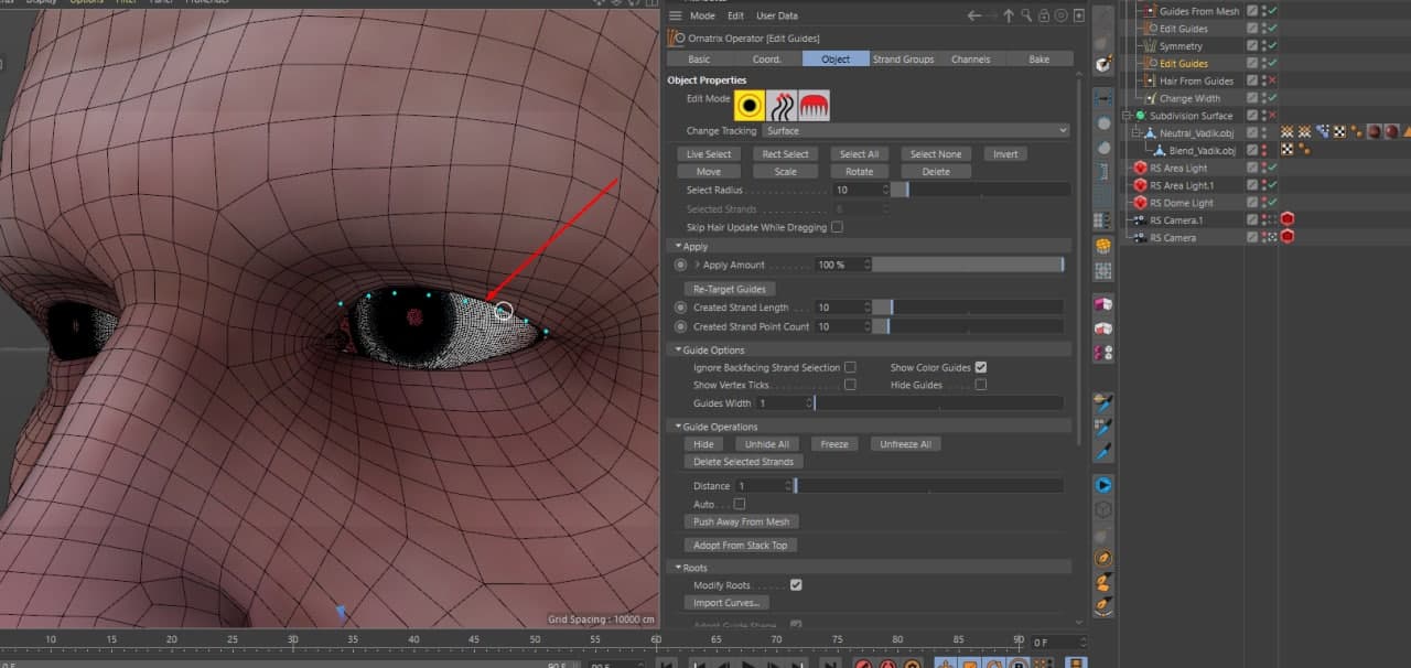

Ornatrix_C4D_R22_2_2.0.8.25423 When I selected guides in edit guide tool the guide are disappear
Posted by:britva_27
Data created:16 November 2020
leaving only the root points visible and then they also disappear. So it is not possible to work with selections
I think this bug was solved a few days ago. Please try the latest nightly build:
https://ephere.com/plugins/maxon/c4d/ornatrix/downloads.html
In 2.0.9.26055 [Nightly] works fine. Thanks for reply
