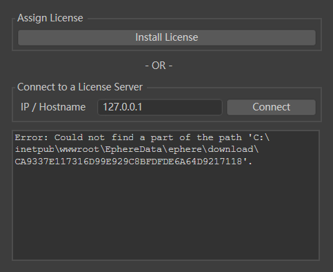

Click on Install License Feedback
Error: Could not find a part of the path 'C:\inetpub\wwwroot\EphereData\ephere\download\CA9337E117316D99E929C8BFDFDE6A64D9217118'.

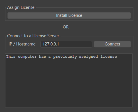

Click on Connect Feedback ”This computer has a previously assigned license”
First, go into your account>My Licenses and release your license. Then reinstall the license server. Let me know how it goes.
I solved the problem by myself. After I shut down the firewall software, I can activate it successfully!
I'm glad it's working.
