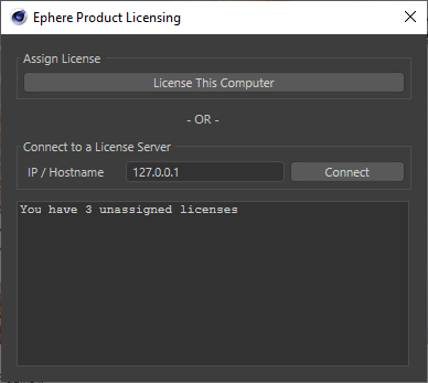

Hey,
I've tested the Ornatrix C4D demo and directly decided to buy a one month license for further testing. But now after installing the licensed version my C4D hangs on "Initializing plugins" whenever I start the application. And when I remove the Ornatrix plugin C4D works fine.
Any suggestions why this is happening? Demo installed and worked fine.
Cheers,
Peter

I just tested on a clean Windows 10 VM with C4D R23 and Ornatrix 2.1.2 latest stable. It does indeed look as if it's freezing on the C4D splash screen with the "Initializing Plugins..." message at the bottom, but eventually the Ornatrix authorization dialog appears.
Do you see the authorization dialog? It should look like the attached image.
Once I authorized the plugin, it worked properly.
