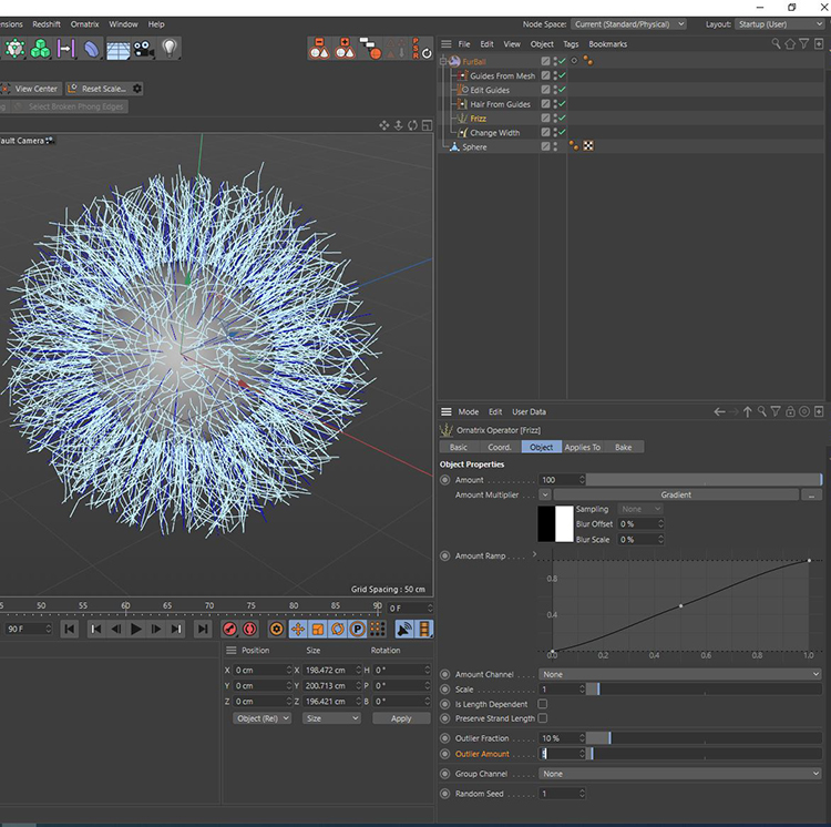

I have detected somes issues with custom drive maps in several nodes.
In "Frizz" node, putting a map in "Amount Multiplier" as just no effect.
More over, there is a bug that I had ever detected some month ago in this "Frizz" node, but I have some difficulties to reproduce it.
Indeed, sometime, when I play with "outlier Fraction" and "outlier Amount", the global amount just stop to respond, even If I re-use the default values for "outlier Fraction" and "outlier Amount". In this case, the only solution I found is to delet the node and began again, and, sometime, It work again.
And in the "Surface Comb" node, the "Slope Multiplier" is just permanantly grey, whatever the options selected, it's impossible to put a map in it.
Did I do something wrong ?
In "Lenght" node, map multiplier work correctly, but when we reload them, the hairs are often not refreshed. We need to clear the map, deactivate the node, reactivate it and re-import the map. Sometime, C4D closure is needed.
Actually, I thik this is more a C4D limitation but, In case of, I prefere to warn you.
