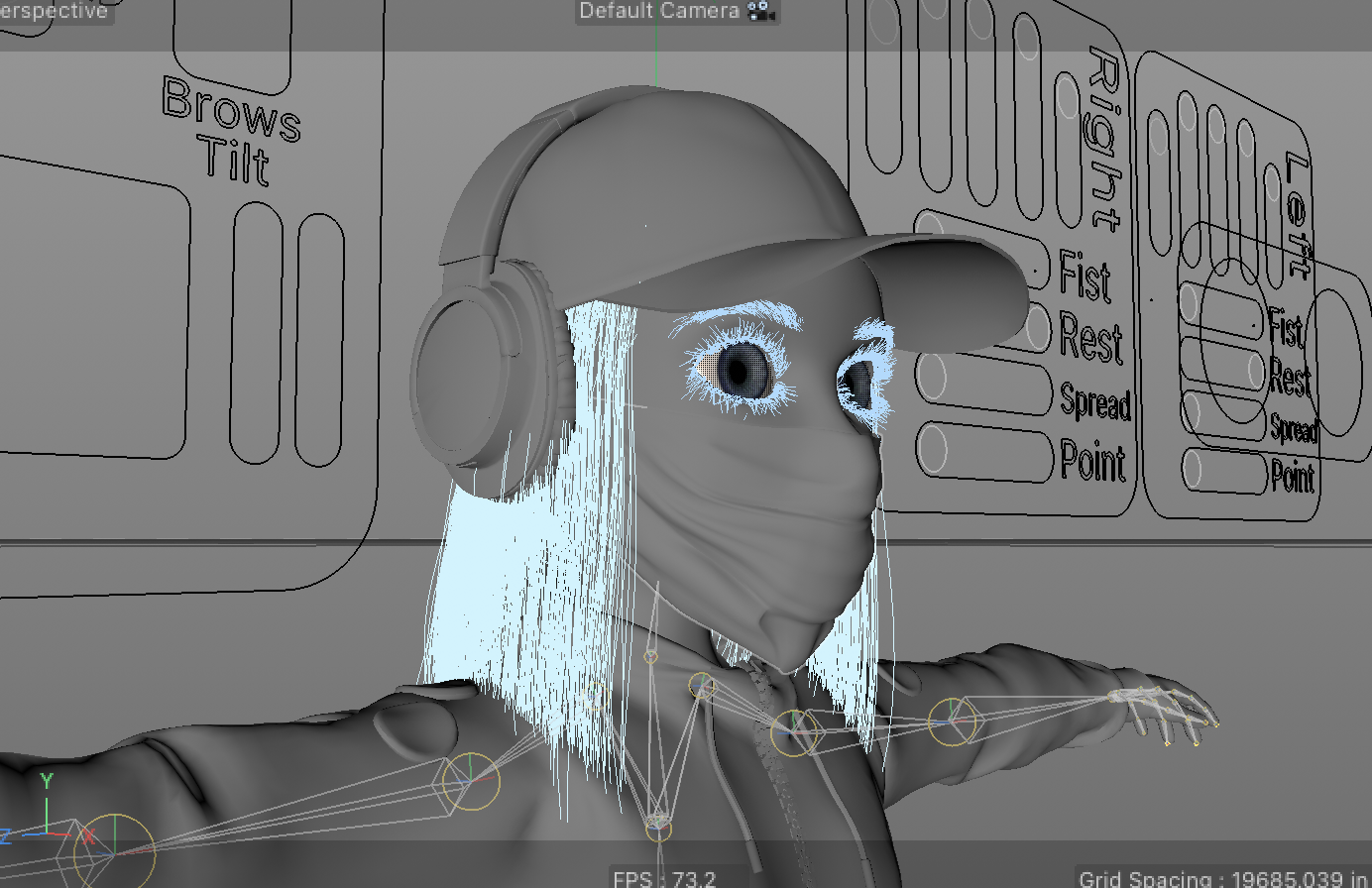

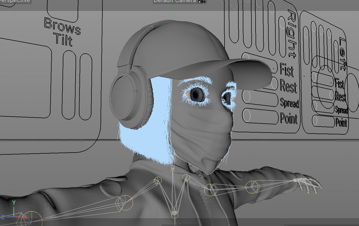

|  | I'm working in C4D Version 1.1.0.26341. Here's two screenshots of the groom. One with the correct short hair and one with the longer hair after I hit the bake button.Attached Files:

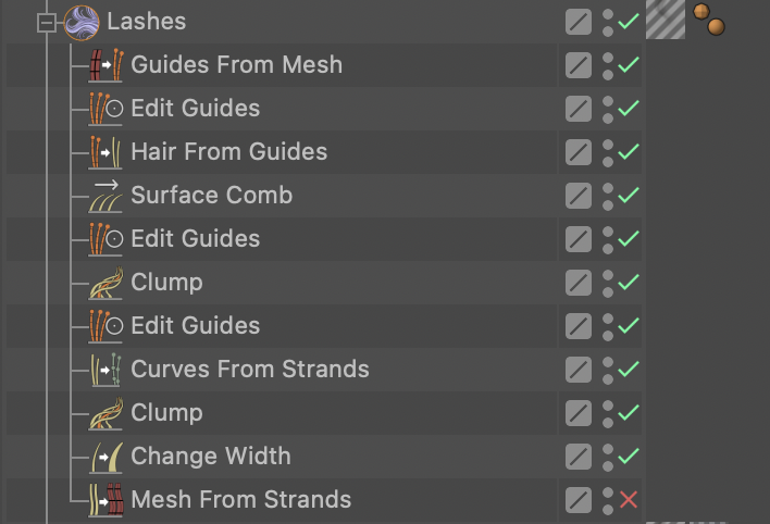

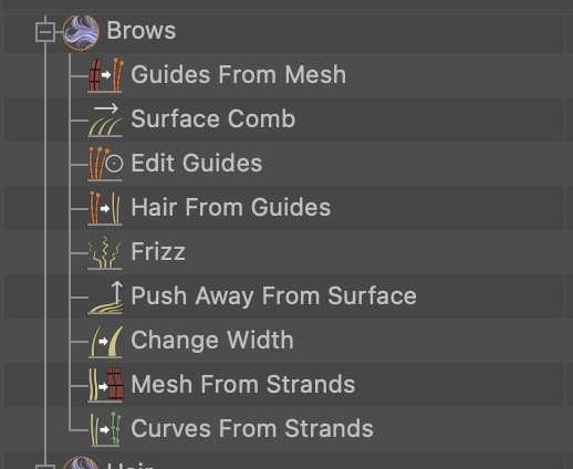

|  | Hmm that doesn't seem to be the issue. When I hit bake after moving gravity after symmetry, the hair still doubles it length and removes some styling. Do we know if this has anything to do with the fact that i only view 10% of the hairs when making edits? And baking somehow messes everything up? Just not sure why this issue might be popping up. The same issue pops up when I try baking the lashes and brows which have different setups. The lengths get longer and it removes a lot of styling. The difference here is that my viewport fraction is at 100%.Attached Files:
|  | The issue is not related to the hair count in the viewport.  The team is looking into this with high priority, I will keep you posted. I can reproduce the issue on V2 but the hair doesn't change that much, just a few strands change it's rotation. To be honest, I think in the best case you would have to upgrade to V2, because V1 is not under development anymore. I will let you know as soon as I have any updates. Jeordanis Figuereo (Product Designer. EPHERE Inc.) |
