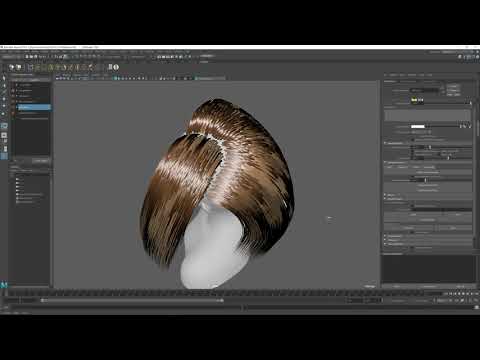

You can use parting based on strand groups to create those type of divisions. Tutorial here:
Ujz_ckatOZE

In this case the only way that I found to do this is adding more guides to better separate the interpolation in the particular area where you want the hair to be parted, then use parting by groups like in the video. Or, adding Moov above HFG so it will interpolate all the hairs without interpolation.
