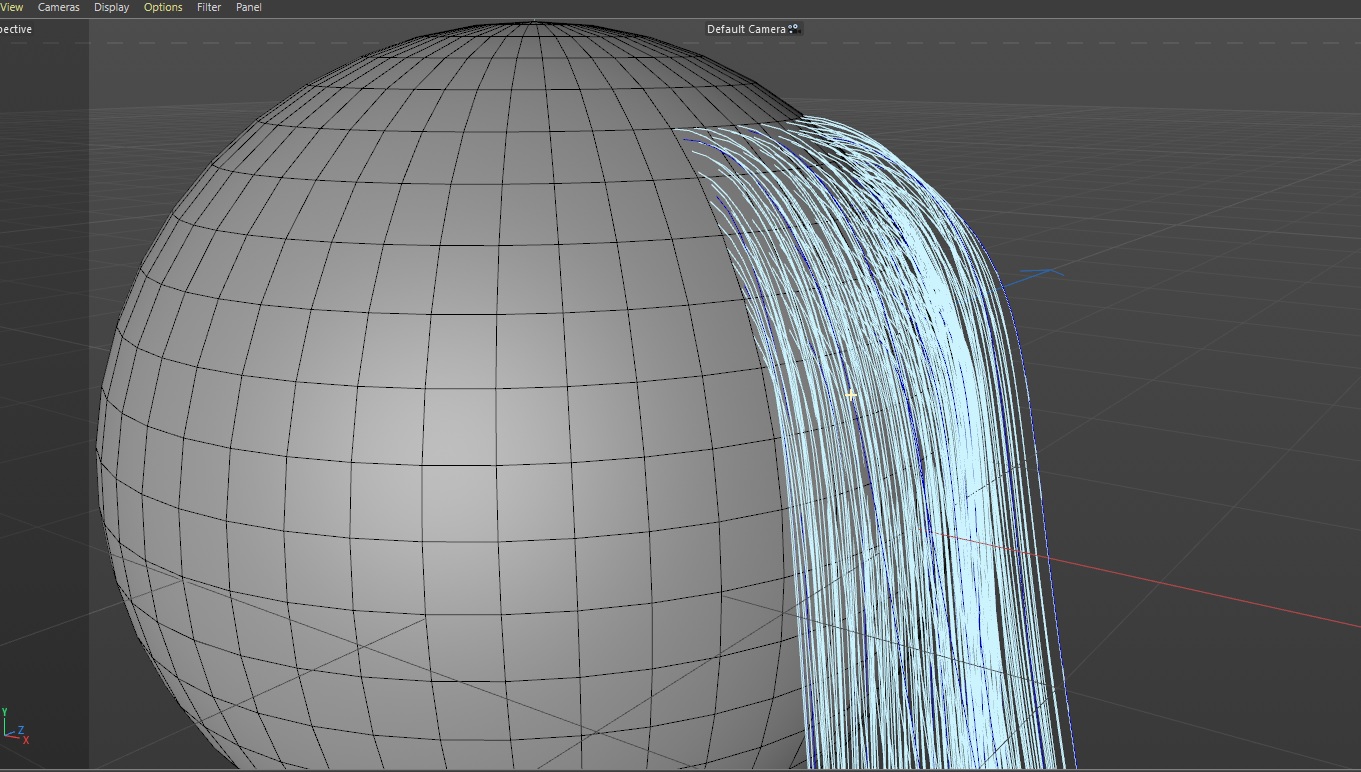

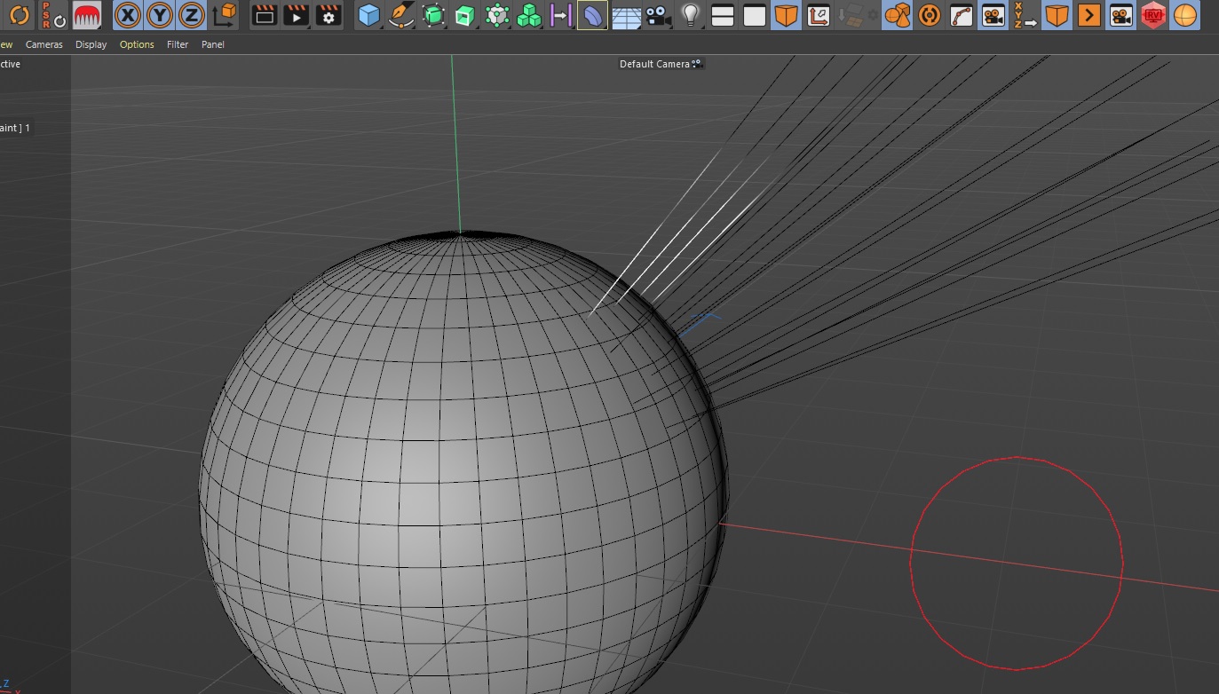

Thanks, I understand what you're trying to do...but how would that apply to a a flat hairstyle that doesn't have that much volume? You're doing a short hairstyle with a lot of bounce and volume. I'm tryin gto do something like the attached pic. When the guides lay flat on the head, the roots that are on the lower hairs will stick out.

I attached some pics to show what I was trying to achieve.
I'm glad to hear it worked. This is actually a good idea. Thank you for pointing it out.
You are right, the Root Stiffness parameter doesn't have channel plug. We will look into it.
