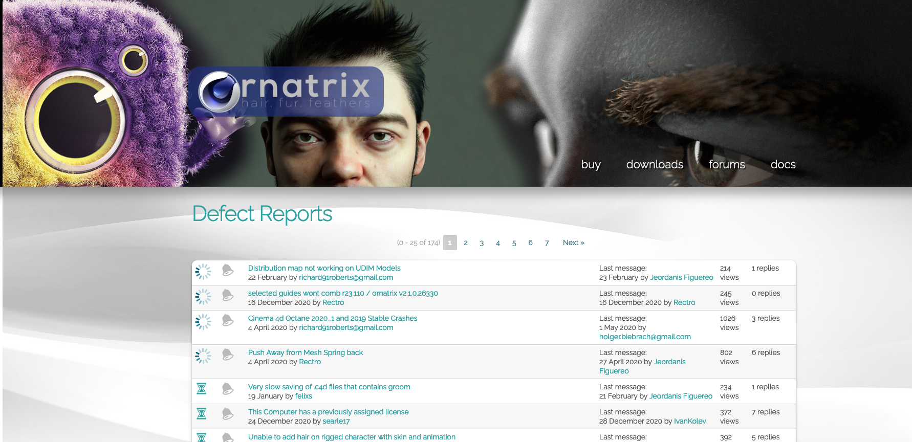

| I'd like to file a defect report on this issue but that discussion group won't completely load *tried three different browsers) and I am not given the option to post. I'd like some help getting this resolved. Thanks, Greg |

| There were significant changes between Catalina and Big Sur.. Many third-party app vendors had issues. I would strongly suggest the QA team have a Big Sur system on which to test... I included a screen shot below I am missing the 'REport a New Defect' button. I have tried three browsers, FIrefox, Safari, and Opera. I get a 'Start New Thread' button on all the other forums. Greg

| I have tried with Google Chrome with the same results. I cannot post to the 'Defects' forum. Greg |
| Hi Greg, Can you record a short high resolution video showing the issue? I can not see very well what is happening in the gif that you provided. I will pass this info to someone with big sur in the team. Regarding the Defect Report page, I just confirmed that for some reason you account doesn't have access to the page, we are looking into. However, right now it doesn't really matter too much, we got your inquiry already. The problem is that we cannot reproduce the issue. The first step to resolve a bug is to reproduce it, which has been difficult on our side. I will see if one of the guys can update or is using Big Sur, but some of us can't upgrade for development reasons. Jeordanis Figuereo (Product Designer. EPHERE Inc.) |
