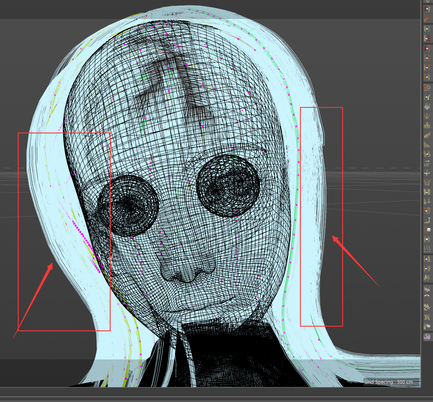

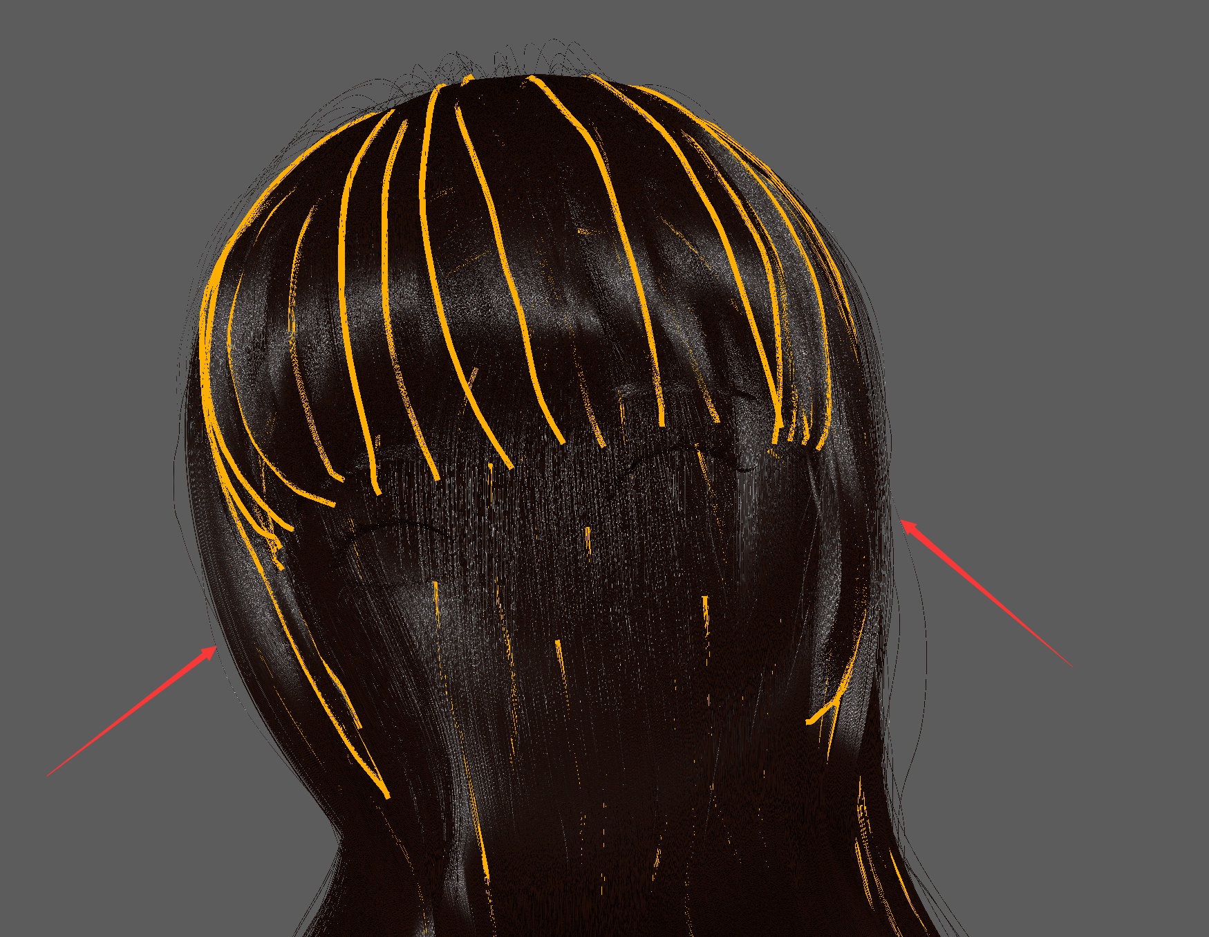

The hair doesn’t follow the guide line a bit
Posted by:hao1009227532
Data created:14 September 2021
The hair doesn’t follow the guide line a bit, how can I do it, it has the same effect as XGen in Maya
Image 1Image 2
To know for sure I would have to look into your scene. But if you can follow this it should work as you expect:
1. Add a distribution map. Reducing the hair distribution area with a distribution map(Multiplier Map) will optimize the hair interpolation, making the hair follow the guides better.
2. Use the default hair interpolation settings in Hair from Guides. The default settings work better for human hair.
3. If this haircut have a parting, use the parting tools(Hair from Guides) to define a parting plane. Defining the parting will improve hair interpolation.
