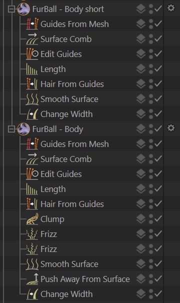

Also I've attached a screenshot to show my modifier stack to see if you think this should work ok or if I need to move anything around (unfortunately I cant upload the clients model).
I've noticed I get better viewport feedback disabling everything from "Hair from guides" downwards, is it ok to temporaily disable these and turn them back on when the animation is done?
Yes. That is acceptable.
