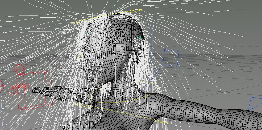

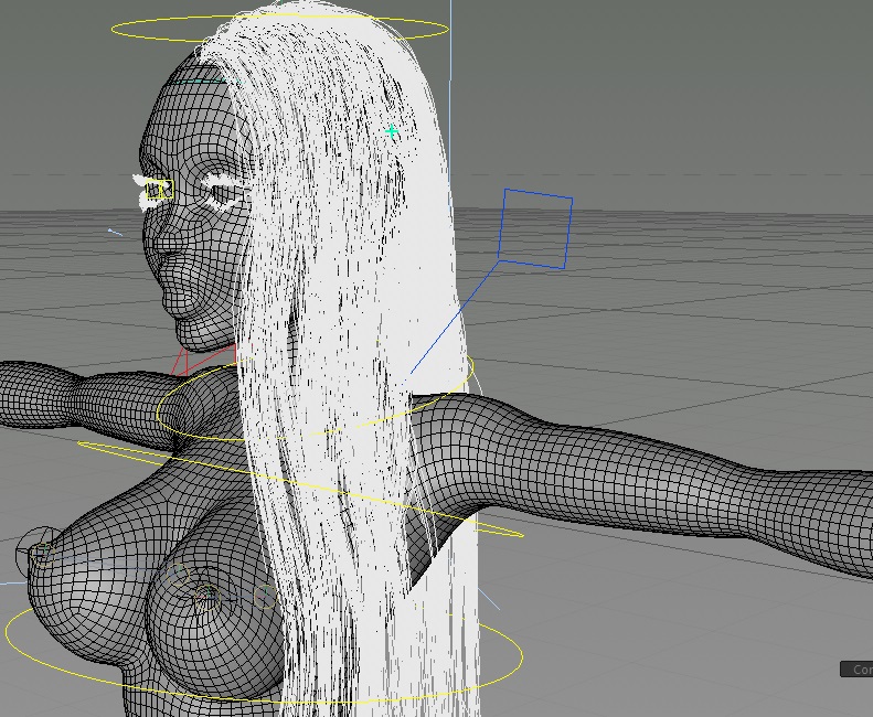

Is this something I can't do? I don't think mesh strip method is of any use if I can't animate the strips. | |
18 June 2022
#31402 | |
It appears that "ground strands" is causing the problem. Is it absolutely necessary to use ground strands with hair from mesh strips? | |
18 June 2022
#31404 | |
You should watch this tutorial. It explains the Hair from Mesh Strips workflow, why and when to use Ground Strands. Then you can decide if you really need Ground Strands. The performance will depend on the amount of strands and strand points/vertices. Keep that in check and reduce it in the viewport for better performance.
