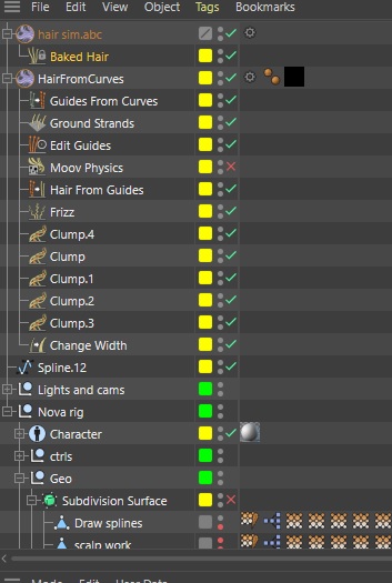

At the top of my stack, you can see the abc I merged into the scene. Is that the correct way to do this?

It works fine here. You had the order of modifiers wrong, recording static strands. Here you can find information about the order of operations in Ornatrix.
Incorrect:
Correct:
Result:
You said "above". What I see is "below."  I was reading the direction wrong.
Thanks for the help.
