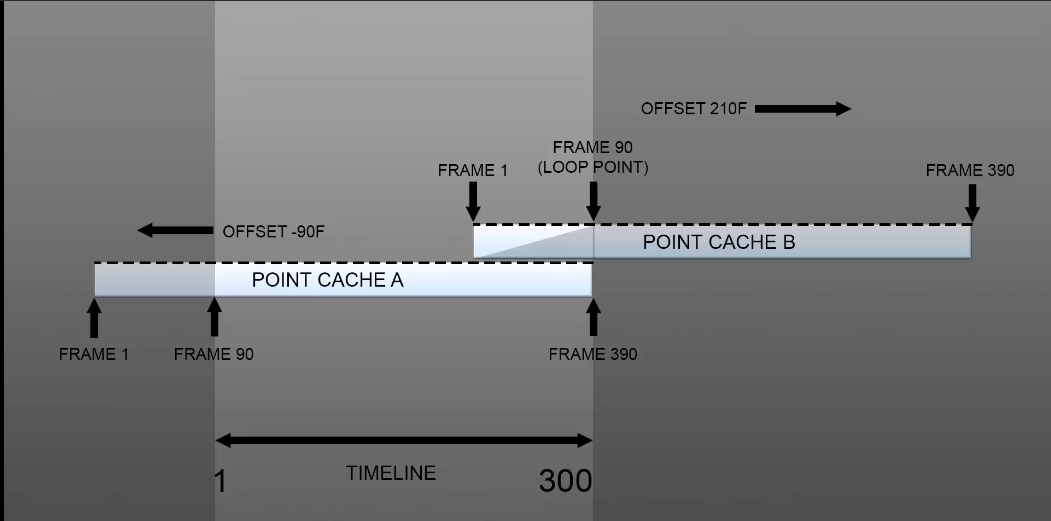

6. Then I followed this simple tutorial from cineversity https://www.cineversity.com/vidplaylist/creating_a_seamless_looping_flag_animation/creating_a_seamless_looping_flag_animation_introduction
I attached an image from the video that kind of showed how I was able to make it loop.
Obviously I was not successful in trying to replicate this for an ornatrix simulation. It fails on step 2, when I try and make the cached hair editible. It becomes a spline.
I exported my hair with "Ornatrix Alembic", merged the Ornatrix Alembic file to the project, then got an "Animation Cache" tag and then loaded the animation. It works really good, no problem with the cached animation.
I just simply cannot recreate the loop that I did with Forester, and I assume that this method (or something similiar) is impossible? :(
