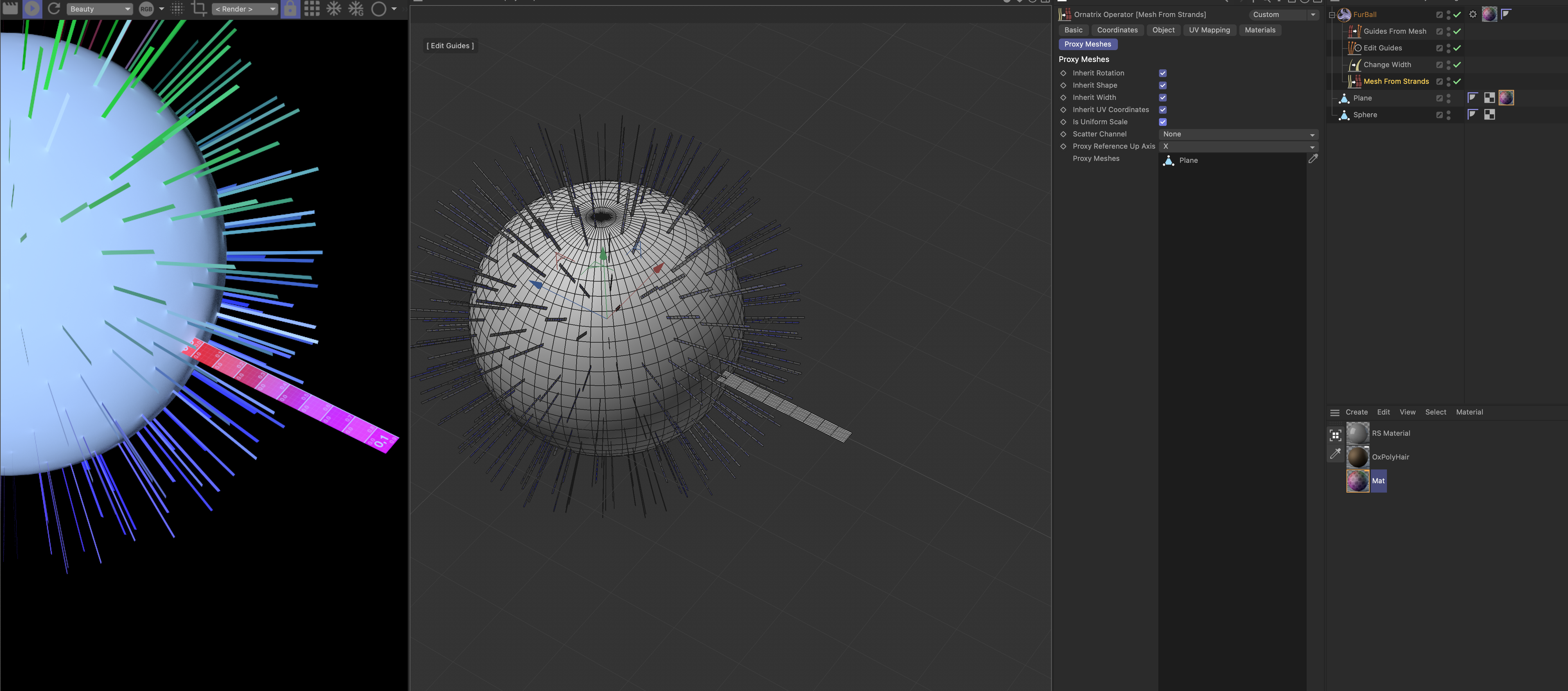

Ok found myself a solution! But there is another problem, I am doing the texturing outside of ornatrix with simple meshes and then using them inside Ornatrix as Proxy Meshes. I followed a tutorial for this, but at my end the Proxy mesh won't show up. Not in the viewport neither in the rendering. I attached my scene file. What am I doing wrong?
>Test.c4d (524032 bytes),
In Mesh from Strands you have to set Mesh Type to Proxy Mesh.
Wow, stupid me. Thanks for the quick help! Working fine now!
