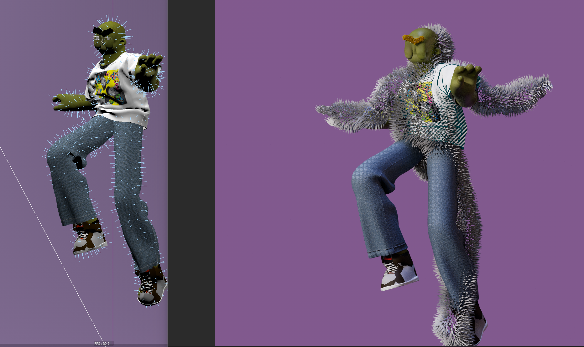

Hi there,
I am having an issue when using Ornatrix with Arnold.
As you can see from the image the hair seems to be flipping on the Z-Axis when rendered in the viewport. I tried it in Redshift and noticed the same thing doesn't happen so it might be an Arnold issue but was wondering if anyone else had come across this.
Thanks,
Nelson
So I think it is Ornatrix, because when I use a native C4D hair object with Arnold it works fine

I can reproduce the issue after cleaning up the original scene. The priority is high so the team will be looking into this very soon. Thanks for your report.
Great, thanks
This is fixed in the latest nightly build. Give it a try and let me know how it goes.
So the issue seems to be fixed with version 3.0.4.32388. Just to check, is that the version you updated? Just asking because I see it's a Beta Version
Yes, but we added the fix to version 2 as well. I a new nightly build should be online.
Hey Jeordanis, just tried version 2 and it is working too.
Thanks for the follow up.
