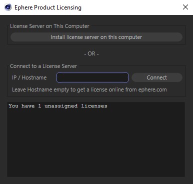

What steps did I need to do to be properly licensed? Yesterday my program crashed and after that, the problems started. I noticed when starting cinema 4d when loading at 2 percent plugins, a window pops up in which it is proposed to install a license server or connect to your own through a hostname. I noticed that the hostname of my computer at the moment, which I do not want to change, and how it signs on the ornatrix website in the licensing section do not match. If I specify the hostname in the window that is on the site, then the plugin does not let it through, if the hostname that it now skips, but after five minutes of working with the plugin, a window pops up that the ornatrix is incorrectly licensed. I need to do a project and urgently solve this problem!
The first thing to try is to release the license and run Ornatrix again.
If you the host name blank Ornatrix will retrieve the license from our website. This is useful if you want to use the license online. Otherwise you can install the license in your machine. To use it online you have to release it first .
Now I try to release the license from the website and run Ornatrix again. After that at the start of Cinema 4d, I see this ornatrix window. After that, I click connect and ornatrix skips and starts the Cinema 4d, the Ornatrix plugin works. But after 5-10 minutes, when I add some new modifier, a window pops up saying that the ornatrix is not licensed correctly. How can I install it? How I can <span>install the license on my machine to use Ornatrix offline?</span>
Click "Install License Server on this Computer" to install the License locally.
