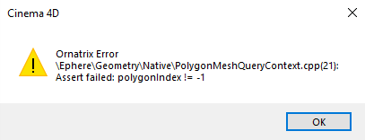

Using the surface comb, when trying to edit a sink, it will crash everytime (see attached error message). Edit Sink > Click on Sink to edit > Crash.
I'm using the latest version of C4D 2023.2.1. I was previously using the latest Ornatrix V3 (stable) had this issue and downloaded V2 (stable) but problem still persists.
Is this a known bug?

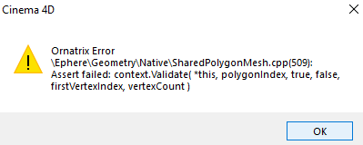

I also get the second error before it crashes ...
Can't reproduce this with a simple sphere as base mesh. Probably your base mesh has something special about it? If you can't reproduce with some simple kind of base mesh either, we'll have to get your mesh to test.
