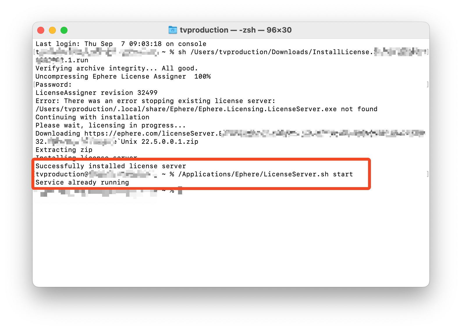

Hi Ivan/Jeordanis,
Have redownloaded the script and executed it again, and can now see that the license is assigned on the 'My Licenses' page and that the license server is running when we look via terminal as per attached screenshot.

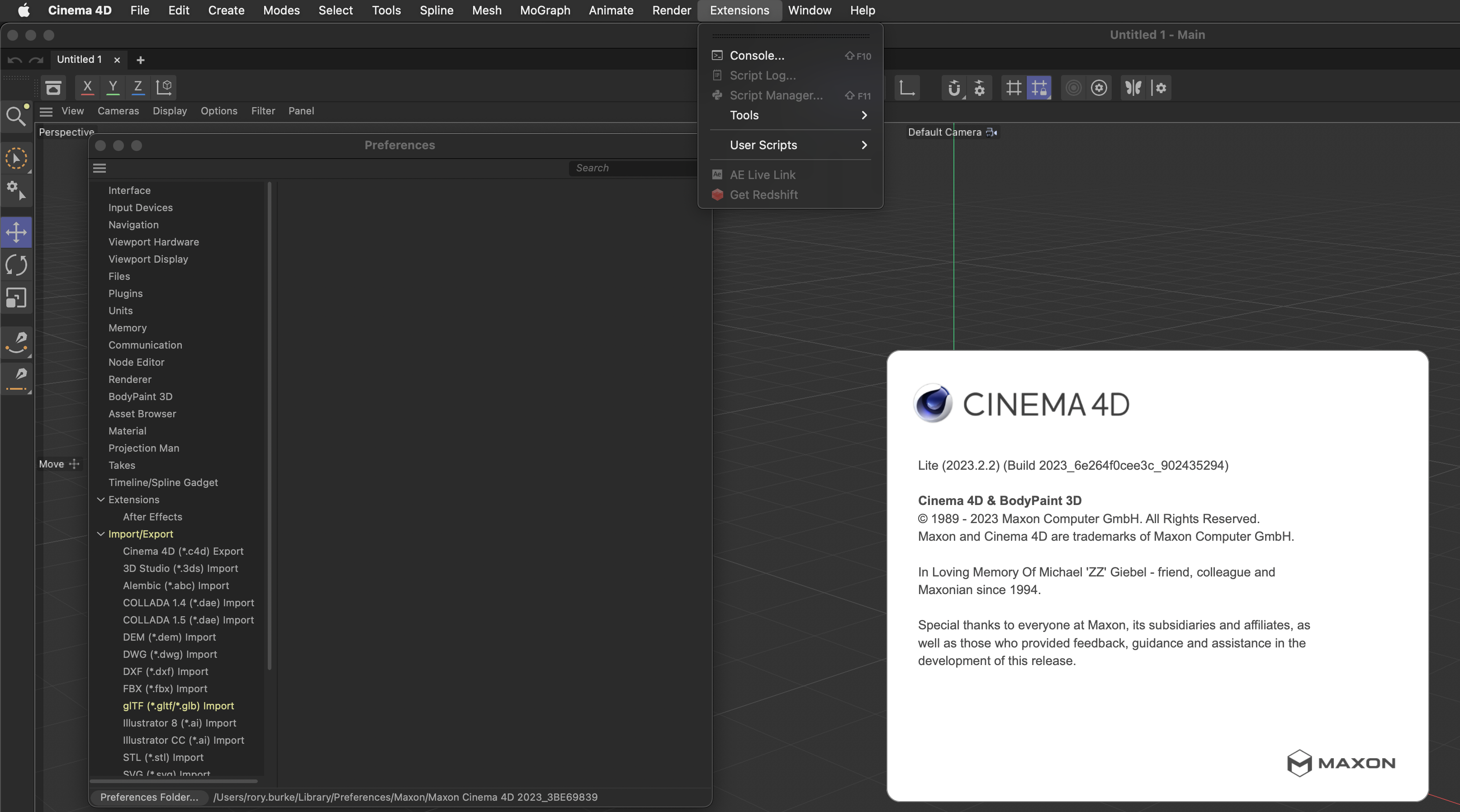

However, when we launch Cinema4D it is missing the application menubar / Extension bar for Ornatrix.
Image 1Image 2
I've also tried to 'Open with Rosetta' for the Cinema 4D.app and still no luck. Have also tried to manually insert the /Applications/Maxon Cinema 4D 2023/plugins folder into the 'Plugins' Preferences window/
Also tried to MOVE the /Applications/Maxon Cinema 4D 2023/plugins/Ornatrix folder to another spot /Users/Shared/Ornatrix & also the ~/Library>Preferences>Maxon>Maxon Cinema 4D 2023_3BE69839 > plugins folder - neither have worked when reloading Cinema 4D.app
An ARM app cannot load a x86 plugin.
I don't know if C4D can run as a x86 app on ARM hardware, but that's the only option to run Ornatrix on ARM Macs.
You can't start the ARM build of C4D as a x86 app through Rosetta emulation, there must either be a separate x86 build that can be installed/run, or a universal build that can somehow be forced to run as x86 on ARM hardware (don't know if that's possible).
In any case, the performance of an emulated x86 build of C4D will most likely be worse than the native ARM build.
