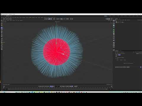

Great performance in this version. makes me happy. But I notice that vertex maps not working.
Does your mesh have UDIM layout by any chance?
vertex maps not working even if I use a sphere or any other meshes for object for groom
example
example
>Ornatrix_vertex_map.c4d (655911 bytes),

Any changes?
3.0.11.34992 - same problem. I'm just reminding of the problem
3.1.0.35015 demo - same problem. I'm just reminding of the problem
The team is investigating this issue. We hope to have it fixed soon.
Hi, any updates?
Checked on my side in 3.1.0.35015
Still doesn't work =(

5VmmkO9DIVY
Timing:
0:00 - Showing Ornatrix C4D version - 3.1.0.35015
0:05 - Creating a Furball
0:09 - Creating a Vertex Map Tag on the Sphere
0:15 - Assigning this tag to the Distribution in GuideFromMesh and seeing that it doesn’t work.

FIXED in 3.1.1.35468 [Nightly]
