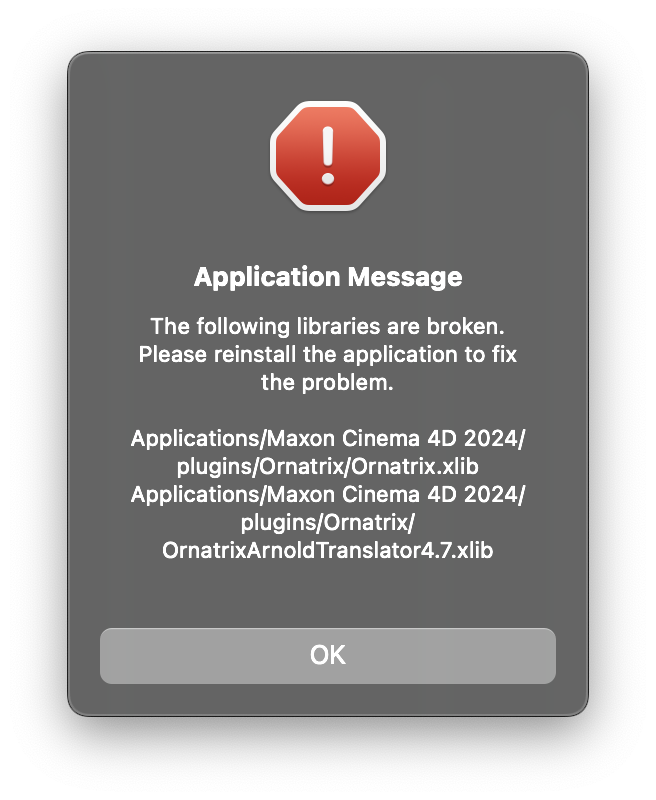

I've tried installing all available versions (3.0.9.34092, 3.0.10.34357, 3.0.11.34822) of Ornatrix C4D v3 for C4D 2024.5.1 for Mac on the download page, and none of them appear to load up and become available on the menu bar when starting the C4D application. When I tried the Ornatrix C4D Demo (3.1.0.35015) installer for C4D 2024, the application crashed. I wonder if the problem is a failure of the app to recognize my previous licenses.
The nightly build that worked was deleted with the latest stable release. But our Mac builds are currently being delayed, a Mac build of the latest stable will appear in a few days.

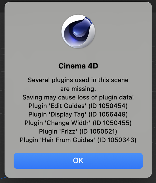

I downloaded the 3.1.1.35468 Latest Stable for C4D 2025.0.2 running on Apple M3 Pro Sequoia 15.3.1
Both archive and installer don't seem to work for me.
Is this latest build expected to work ?
Opening a previously made project I get this pop up telling me it's missing the plugin.
Do you start C4D in Rosetta mode?

Didn't know about this Rosetta mode.
First of thanks it worked.
