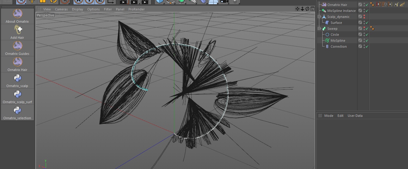

| Hi Dan I use Customize dialog to get objects from Ornatrix plug-in and set them to custom pallete. Also i put scripts(i post them in this topic). You invoke Add Hair, plug-in commands make Ornatrix hair object(from groom presets is Furball name) and ornatrix tags. I think Ornatrix Guides object is helper object or w-i-p object |
| Fields work just fine in selection tag (as source mesh for Ornatrix) Looks like most important step is "refresing" of selection. Attached Files: |

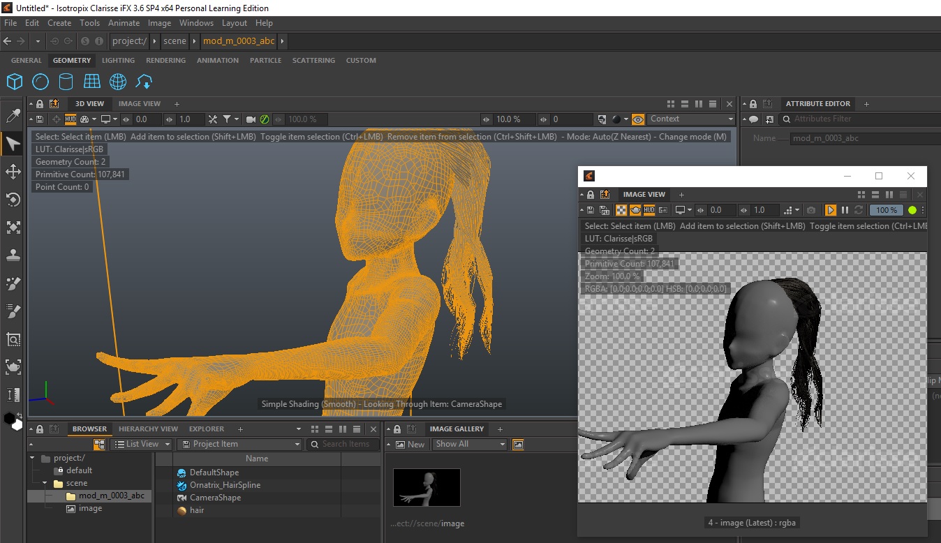

Testing of alembic curves for Isotropix Cla Attached Files:  |
