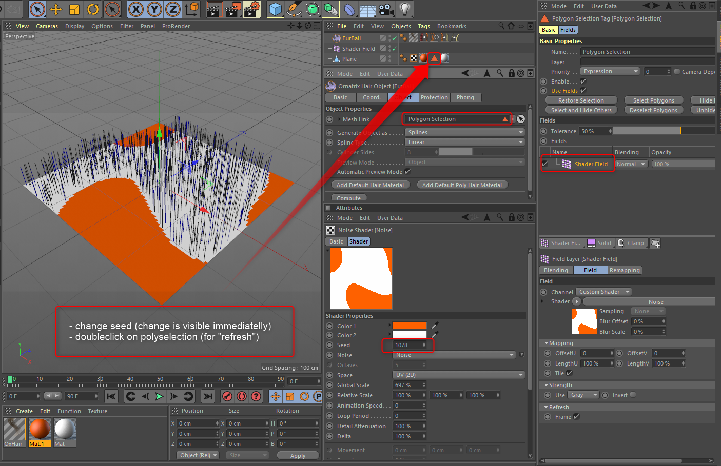

Hi!
I can not find feature that supports selection.
There's two ways to do it, both using a Selection Tag. You can either drop the tag into the HairObject's Mesh Link, or check GuidesFromMesh's Use Face Include and it will to use the first selection tag of your mesh.
Generate Groom From Selection - does not work, i can not save grooms
This feature is currently not implemented.
Hello Roger
Thank you for tip. I did not check out such solution. It works!

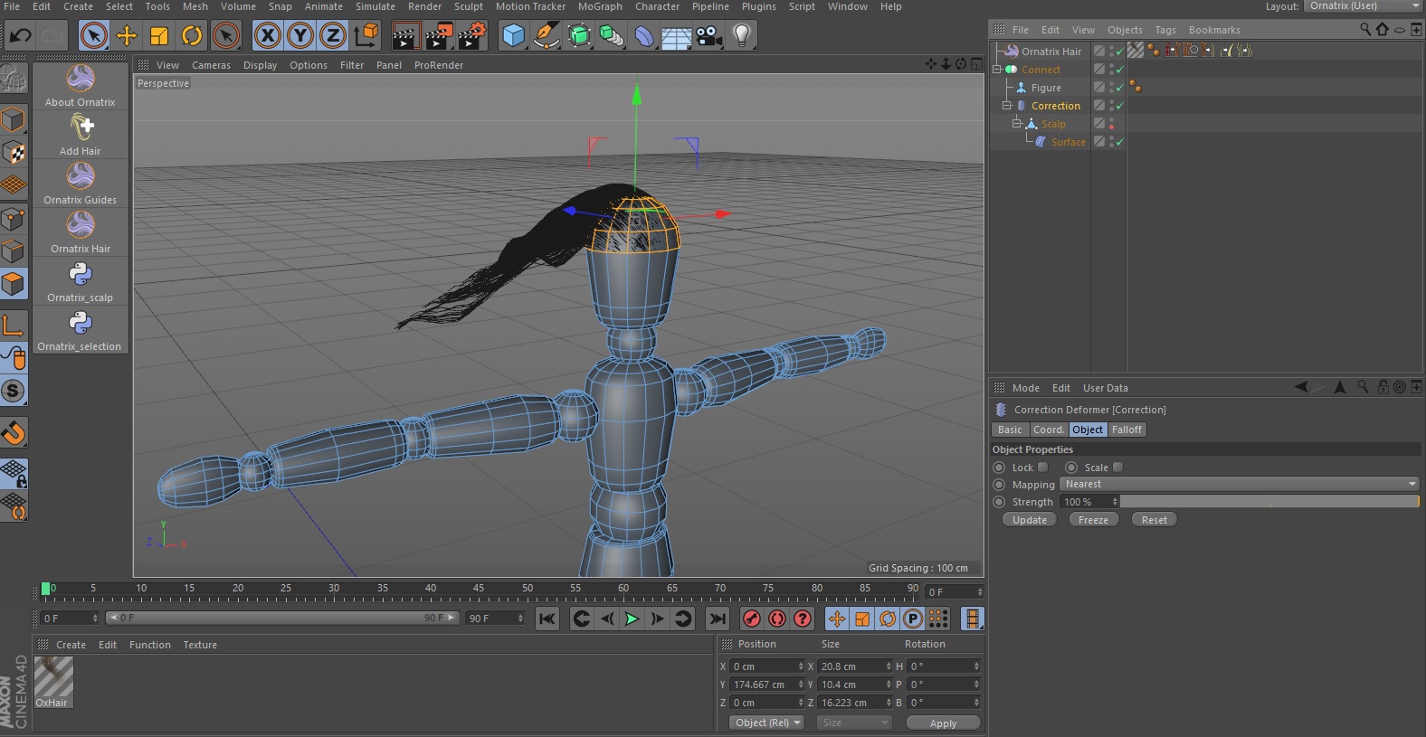

@ilay7k  In your screen shot you seem to have way more options Than I see in r20, I only have add hair and Im on the latest nightly build 17126?
Thank, Dan
My Web Site -  ArtStation
Hi Dan
I use Customize dialog to get objects from Ornatrix plug-in and set them to custom pallete. Also i put scripts(i post them in this topic).
You invoke Add Hair, plug-in commands make Ornatrix hair object(from groom presets is Furball name) and ornatrix tags.
I think Ornatrix Guides object is helper object or w-i-p object
Fields work just fine in selection tag (as source mesh for Ornatrix)
Looks like most important step is "refresing" of selection.

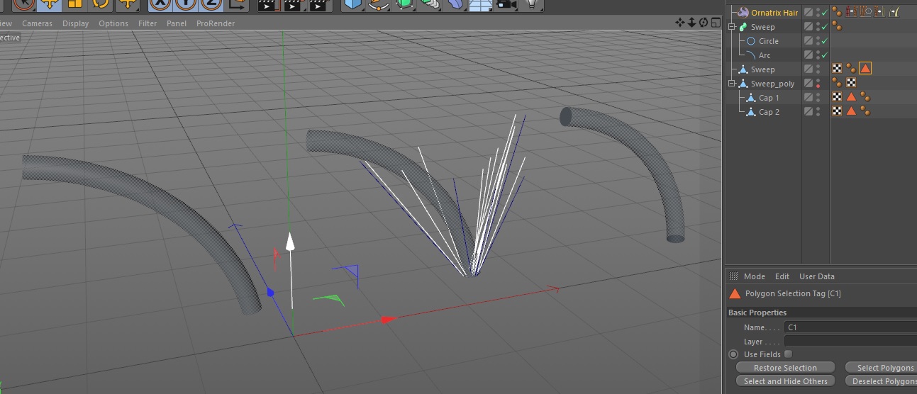

Same test with sweeped splines(curves) as poly by correction deformer
Hmm interesting. Maybe we should prioritize Hair From Mesh Strips object/tag.
You mean in volume object like in maya manual?
Cylinder volumes are also supported, yes.
Cool! Thank you
