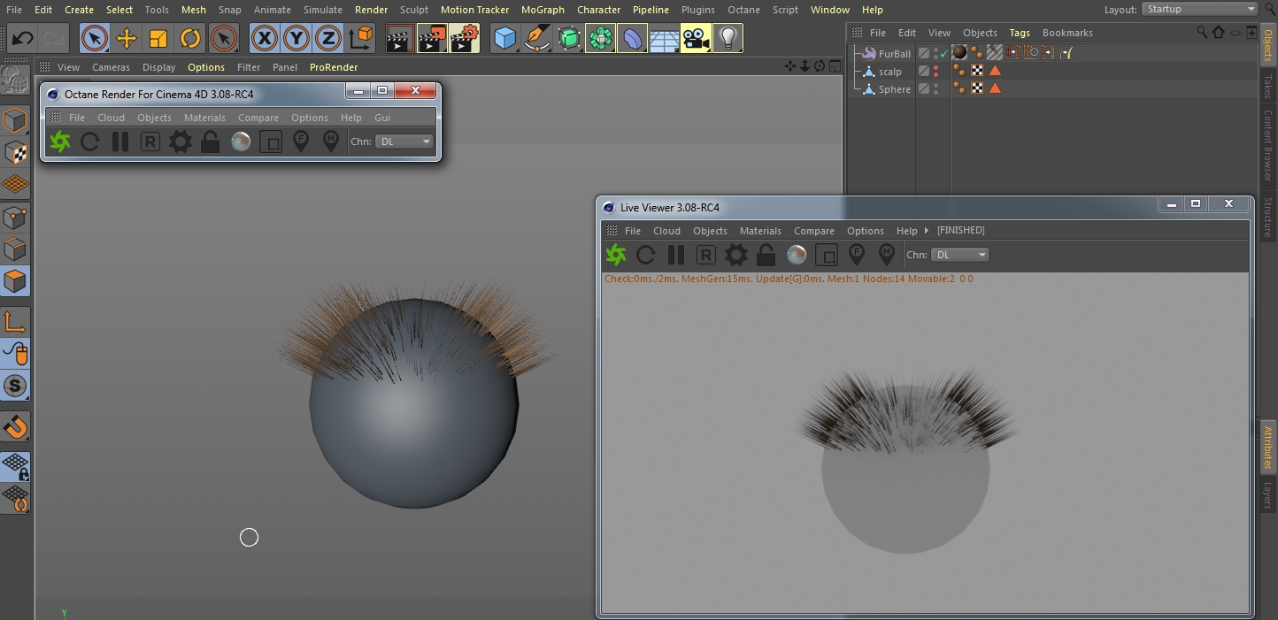

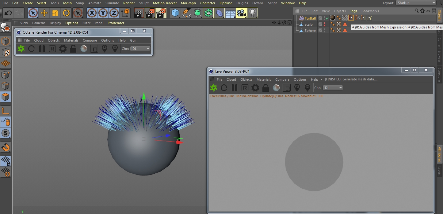

Sorry if I don't post in the right place . I noticed that as soon as you select a tag , hair disapear in the renderer : Attached Files:  |
| Odd, we'll have a look thanks Marsel Khadiyev (Software Developer, EPHERE Inc.) |
| Is this only related to Octane preview render? |

| Hi same in C4DTOA. I am using the 2.4.2 version. If I lock the tag to display it everytime, then I unselect the tag it render and I can tweak it. |
| Hi guys, The Tag workflow is being migrated to Modifiers/Operators. We will address this issue if it is still reproducible after that. Thank you. Jeordanis Figuereo (Product Designer. EPHERE Inc.) |
