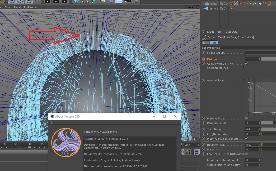

| I touched non last night build and new tag-modifier Push Away works fine for me Attached Files: |
