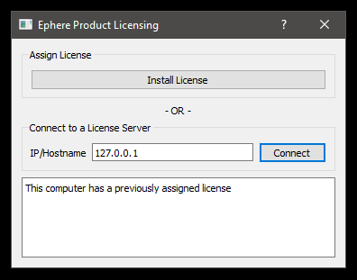

After installing either the last stable or the latest build and then launching C4D R20 I am prompted with a message box stating "This computer has a previously assigned license". I have followed instructions to remove a previously installed and running license server, but there is none. Dismissing the propmpt causes the plugin not to load. I also tried the "Assign License" option but that complains about a server error (I understand this shouldn't be neccessary but thought I'd try anyway). I've tried multiple un-installs and re-installs. I think I may have installed the demo version for Max a while ago, but that has long since been uninstalled. Any idea what is causing this?

You might try to install just the license server from the "Install license server only: Previously licensed computer" link on the Downloads page (for your OS, looks like Windows).
You can also look at the https://ephere.com/licenses.html page to check your existing licenses. Have you ever installed other licensed Ephere products? (demo versions do not use the licensing system)
If you can't make it work, I'll have to ask you to try some commands from the Command Prompt.
