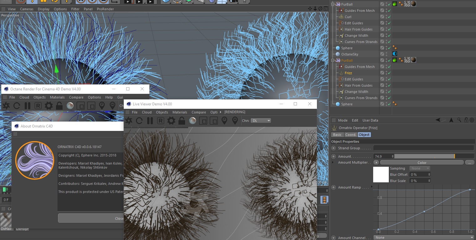

| Hello All works. If splines - add octane object tag and Curves From Strands operator I'm using deformers after Guides From Mesh operator or if add chaotic-artistic view - next after Hair From Guides

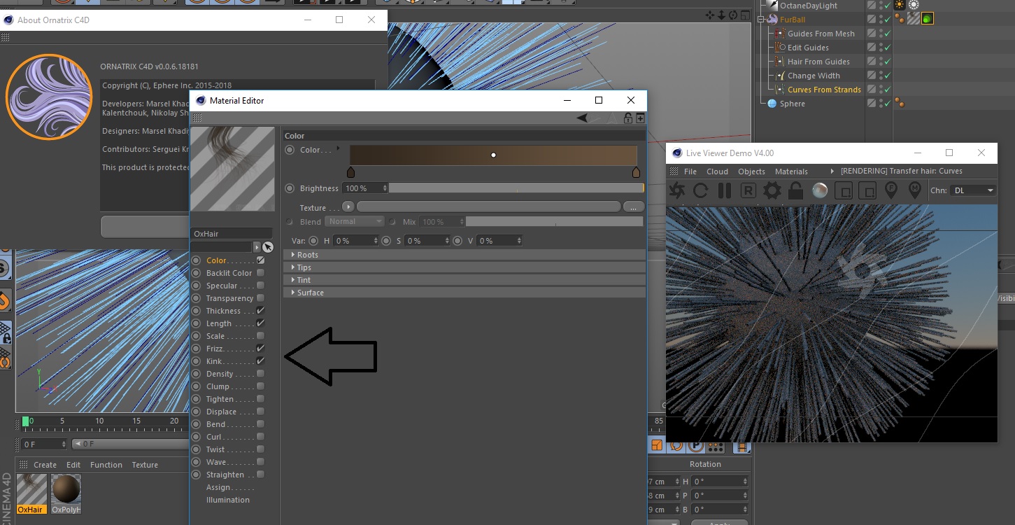

| Have you use last nightly build? To render splines from Ornatrix, you need to add Octane object tag with turn on Render As Hair in Hair tab and add Curves From Strands operator from ornatrix fur/hair object. Or if you render poly hairs, add Mesh From Strands operator from ornatrix fur/hair object and octane material
About deformers like Frizz, Curl and etc. look at picture |

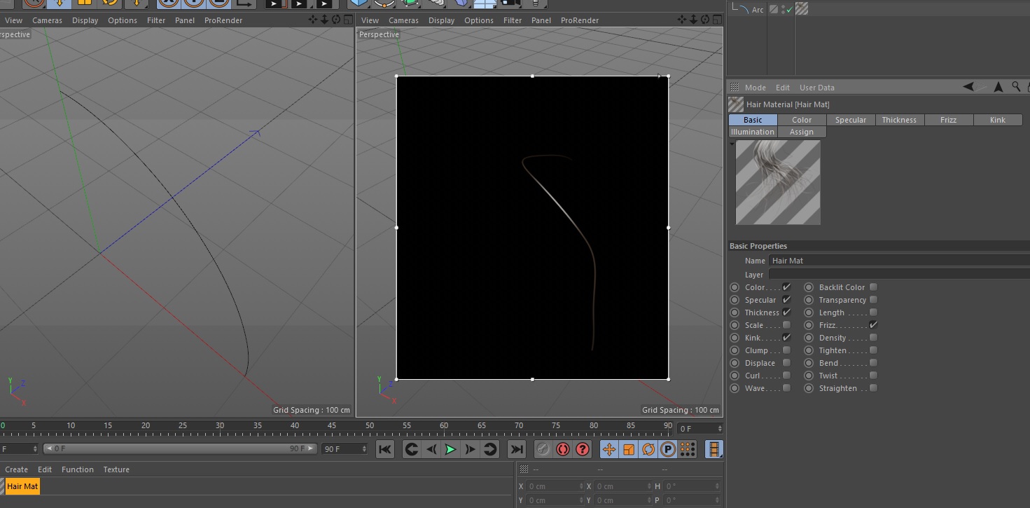

| sorry, i do not like Octane. I saw that it supports c4d native hair object. But not hair material! try such with native hair renderer  or native .jpg)
Attached Files: .jpg) |

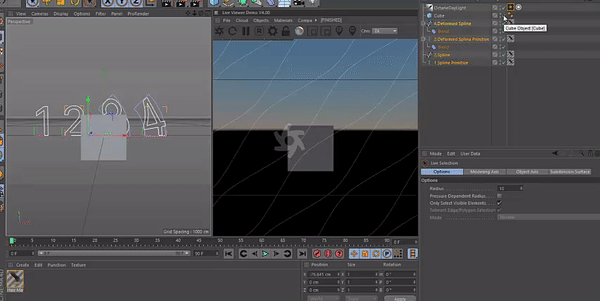

| Hi! Unfortunatel I don't have Octane here to test, but would be really helpful to understand what can Octane render as hair so we can generatethe same kind of object. I'm attaching a scene with 4 different splines, can you test which ones Ocante can render? Also, I need to know the ID of the Octane Object tag. To do this, please drag the tag to the Command Line ( Open Console, Advanced, Command Line...), press ENTER and get the output from the Python console. |
| Hello Roger You can use demo of Octane, imho c4d.BaseTag object called 'Octane ObjectTag/Octane ObjectTag' with ID 1029603 OctaneObjectTag[c4d.OBJECTTAG_RENDER_AS_HAIR] = True OctaneObjectTag[c4d.OBJECTTAG_RENDER_AS_HAIR] = 1 OctaneObjectTag[c4d.OBJECTTAG_HAIR_TIPTHICK] = 1.0
and splines render with tag
Attached Files: |

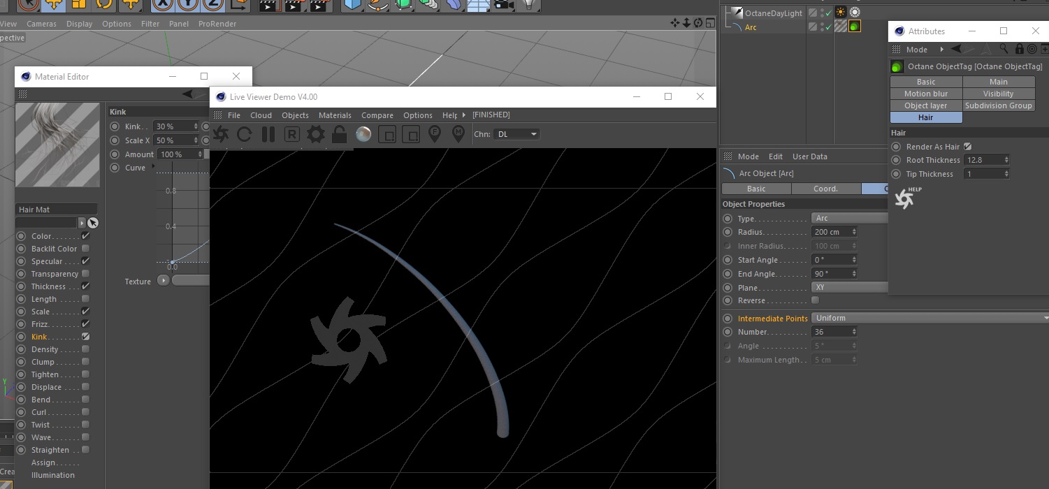

| But last build does not work with c4d hair mat and octane 4. That's problem Deformed spline in Ornatrix enviroment by c4d hair material settings does not render by octane Attached Files: |
| We use the standard C4D material to render curves. At this moment, the only parameter we change on the material is the Width, all the others will be applied over the Ornatrix Hair. So Ornatrix Frizz is competely independent of the material's Frizz. If the material's parameters are affecting Octane, that's a Octane issue. @jayroth commented that Octane does support the hair material, then probably thats the case and you need to use an Octane material. |
| arghhh, i'm not fan of octane. i want to help to make product better ;) I show Jay ornatrix deformers |
