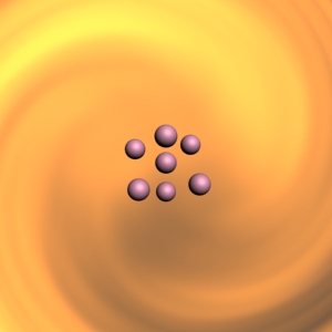

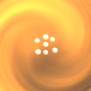

|  | and  why... i can render the object ,but , very strange def jpg if f9 render dotnet is my code render ... Looks,like  have so  strong light ======================this is my code =====================   IViewParams theViewParams = MaxGlobal.ViewParams.Create();IViewExp theViewExp =  MaxGlobal.COREInterface.ActiveViewport;
 IBitmapInfo theBmpInfo = MaxGlobal.BitmapInfo.Create();
 int theHeight = theViewExp.Gw.WinSizeY;
 int theWidth = theViewExp.Gw.WinSizeX;
 theHeight = 300;
 theWidth = 300;
 theBmpInfo.SetType(7);
 theBmpInfo.SetWidth((ushort)theWidth);
 theBmpInfo.SetHeight((ushort)theHeight);
 theBmpInfo.SetFlags(1);
 theBmpInfo.SetCustomFlag(0);
 IBitmap theBitMap = MaxGlobal.TheManager.Create(theBmpInfo);
 IFrameRendParams theFrameRendParams = MaxGlobal.FrameRendParams.Create();
 IRendParams theRendParams = MaxGlobal.RendParams.Create();
 int RenderResult = 0;
 IINode theViewCamera = theViewExp.ViewCamera;
 MaxGlobal.COREInterface.OpenCurRenderer(theViewCamera, theViewExp, RendType.Normal, theWidth, theHeight);
 Rectangle theRendRec = new Rectangle(0, 0, 100, 100);
 theBitMap.Display("55", 5, true, true, null, null);
 RenderResult = MaxGlobal.COREInterface.CurRendererRenderFrame(0, theBitMap, null, 1.0f, null,theRendRec);
 this.Text = RenderResult.ToString();
 MaxGlobal.COREInterface.CloseCurRenderer();
 theBitMap.Dispose();
|  |   how to undisplay the bitmap? For some reason it exported as property. To close do: int tmp = theBitMap.UnDisplay;   Looks,like  have so  strong light I am not sure why you're getting it. I just tried your code and light is ok in my render. Perhaps you're not setting the exposure properly in atmospherics?Marsel Khadiyev (Software Developer, EPHERE Inc.) |
|  | my scene envionment map setting a sxirl map .......... after this effect ..... but pressed f9 key render  not like this |
|  | theBmpInfo.SetType(6    is ok :) |
|  | Good to see you figured it out :)Marsel Khadiyev (Software Developer, EPHERE Inc.) |
