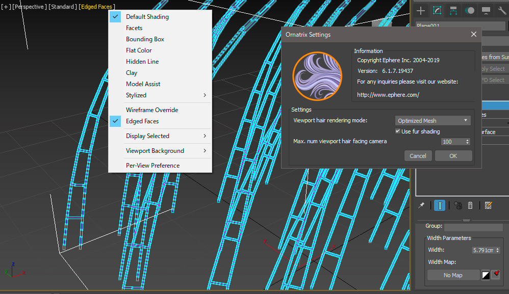

-  Moving a strand at the root level of Edit Guides will rotate unintentionally.
- Edged Face Problem in Optimized Mesh Mode Recurred
We are still working on this one. I will keep you updated.
Attach Step By Step based on the Plane.
>root_rotate_problem.mp4 (14142316 bytes),

Thanks Yuji,
I was able to reproduce this issue based on the second video you sent. We are working on the issue now and will update you when its addressed.
Thanks again
Michael
Please try the latest nightly build, 6.1.8.19594 or later.
