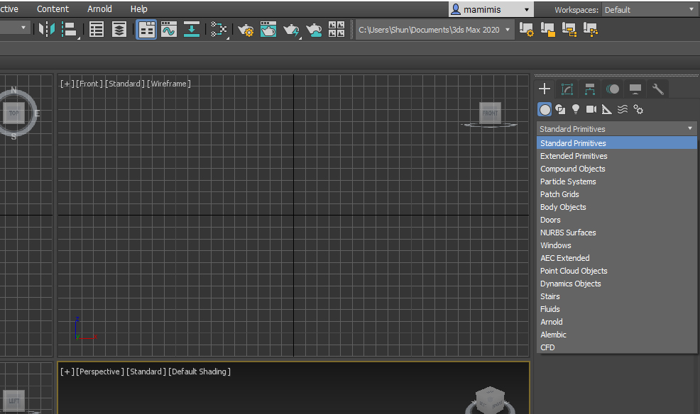

Since I bought a new computer, I disactivated my Ornatrix licence and tried installing it for new one. Installer says it completed installation but "Ornatrix" menu won't show up in my MAX.
I tried the command "OxAddToolbar()", also resetting to default workspace, but didn't work.

Version 5 of Ornatrix doesn't support 3ds Max 2020. I can see in the Install.log file you provided that no other 3ds Max version was found, so the installer probably copied just the grooms and curve presets files.
