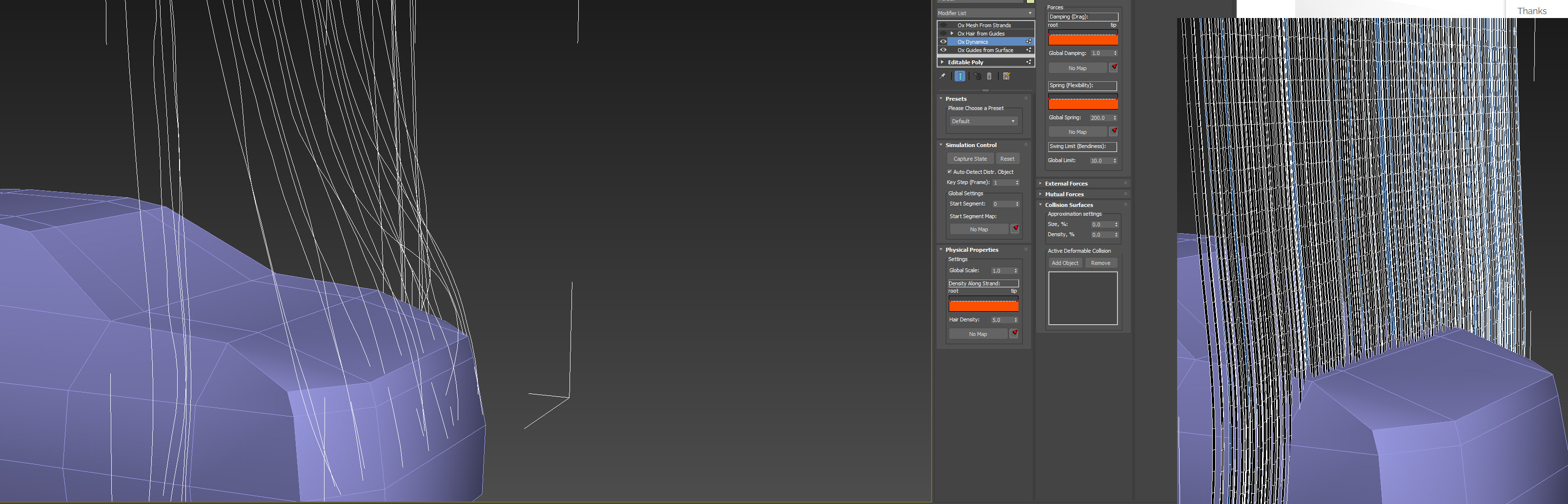

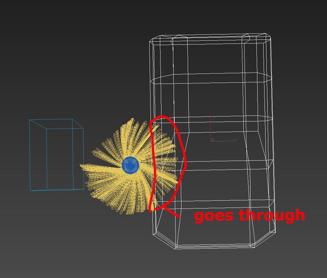

When we used version 5 we were able to get hair to collide with rigid body.  In version 6 we jsut cannot.
Can you look at the scene attached? What are we doing wrong?  we use max 2020

Guides work but hair is not working

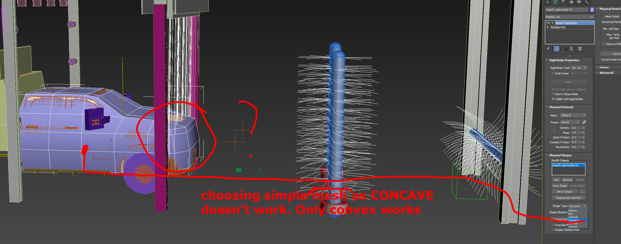

Were you able to find out why? Also choosing my rigid body as concave will not work with hair.  Is only convex allowed?  Thanks
Try Ox Moov Physics modifier. We do not support the Dynamics modifier anymore.
