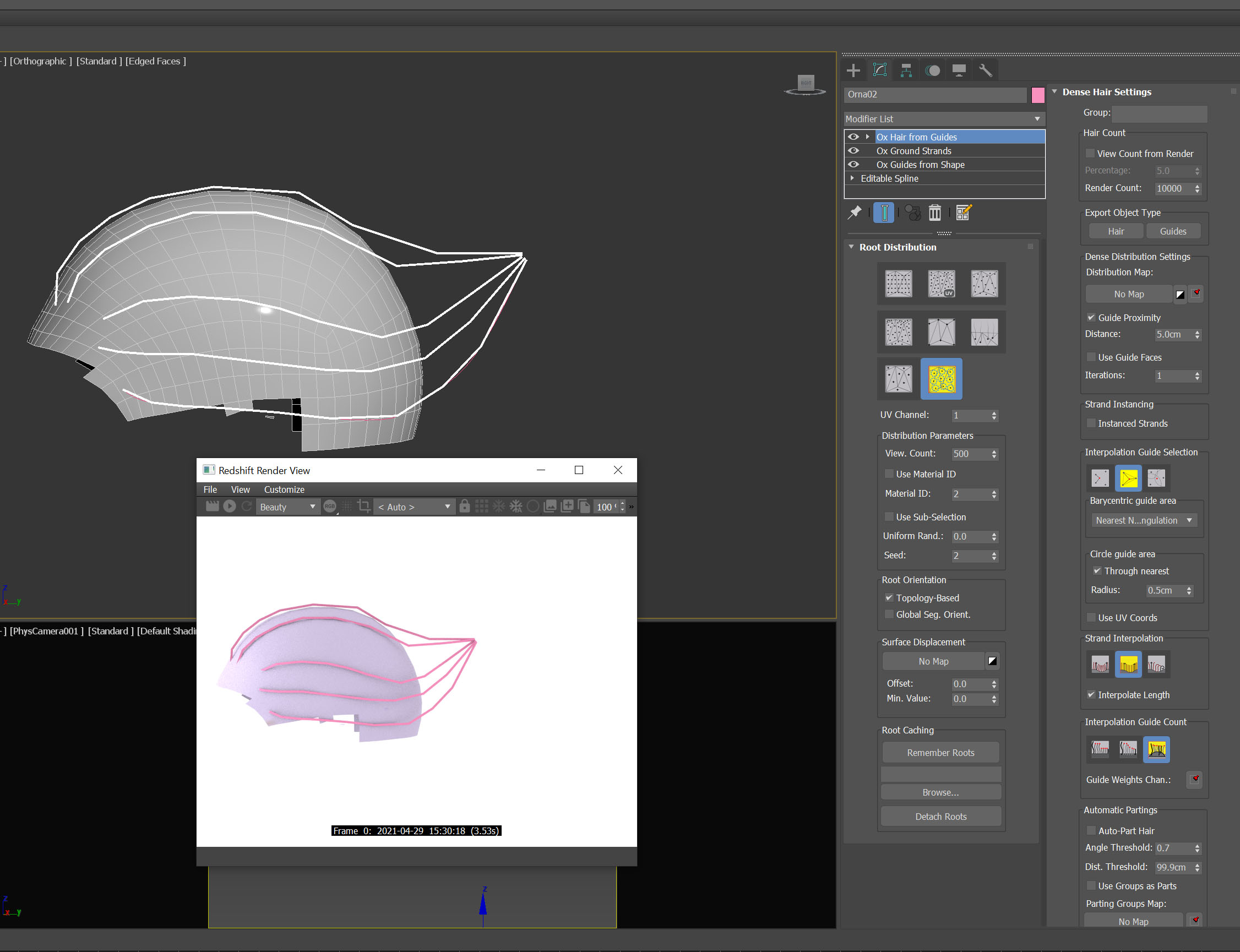

Hello, I have created some splines and  added Guide from Shape , Ground Strands, Hair from Guides, as attached.
No hair shows neither in vieport nor in rendering.
Could you tell what I am dong wrong? Using Max 2019 Ornatrix 7.
Thank you
Yoshi
Hi Yoshi,
In Ground Strands modifier, make sure that the roots are attached to the scalp mesh.
Herllo Jeordanis, Im sorry but how exactly do you mean by attaching the roots?
beside adding Ground Strands modifier?
Yoshi
Here you can find some videos explaining how it works. The two latest videos are more updated and they explain the issue that you are having. Basically you have to select a distribution/base mesh and click Attach Roots.

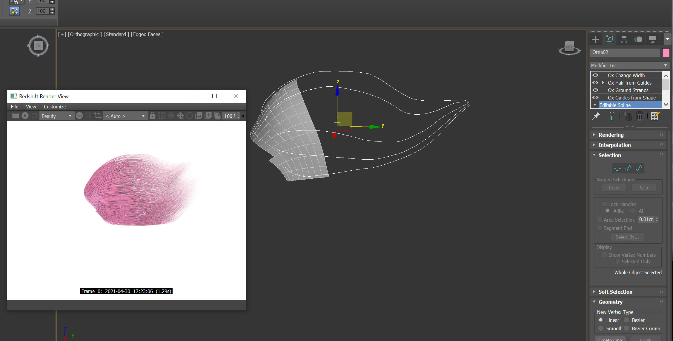

Thank you. I was able to produce hair after restting transforms per tutorial. Is there anyway to make hair folloow the splines more closely?
Hair seems to spred out quite a bit. Please see attached. I would like hair to come to a point at right.
That is hair interpolation in action, is working as expected in this case. To allow the hair to interpolate as you expect you have togive it more data. In THIS video Michael explains exactly what you are trying to accomplish.
