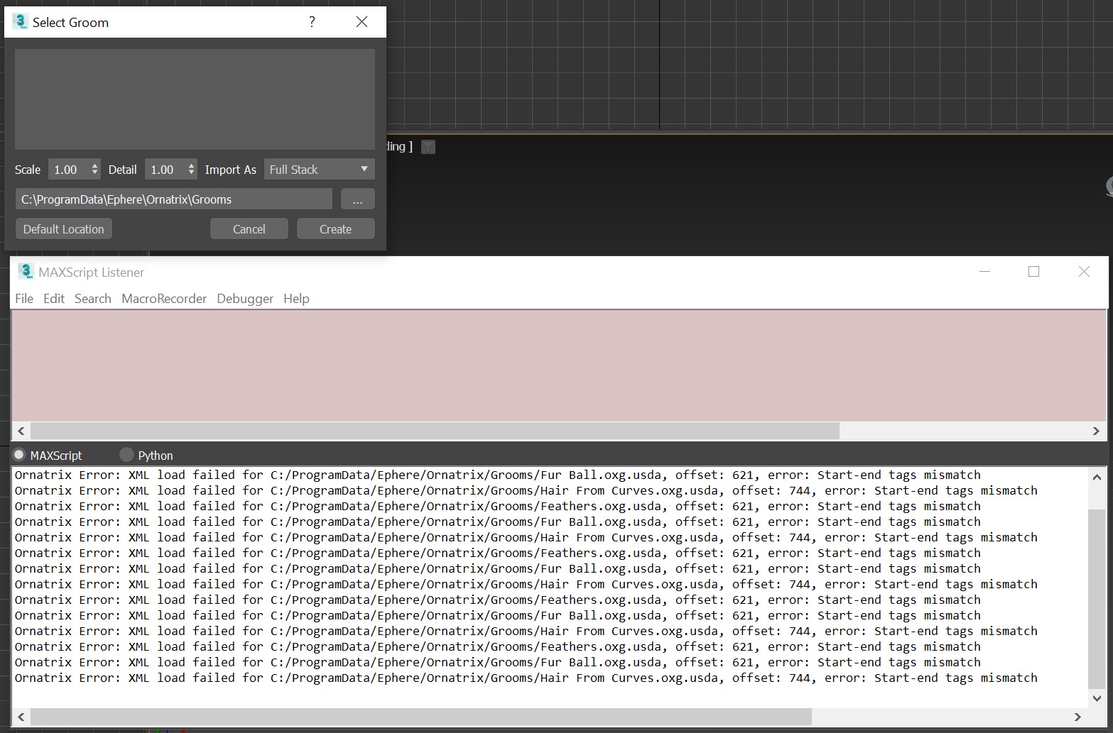

Pleae check the attached image.
On my computer, almost all the recently updated versions cause the following error.
All I did was create a new scene and create a new sphere, then click Add Hair from the Ornatrix menu bar.
This opens the Select Groom window, but there is nothing in it.
And Max Script Listener shows a lot of error messages at the moment.
Only Ornatrix_3dsmax_2022_7_7.3.4.29985 works normally on my computer.
Is there any way to solve this problem?

Hi Jeordanis Figuereo and IvanKolev,
I installed the version 7.3.6.30261 you mentioned today and the problem did not occur.
When I look at the screenshots of Jeordanis Figuereo, it seems to work fine with the same version without any problems, so this problem seems to only appear on some computers.
Is there any other way I can do when this problem occurs in a future version? Is waiting for a new version the only way?
