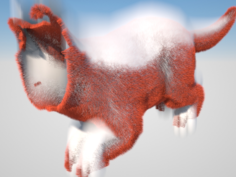

It seems that there is no MB when using octane and an animated animal  with octane proxy.  Please see the scene attached.  please go to frame 410 Thanks

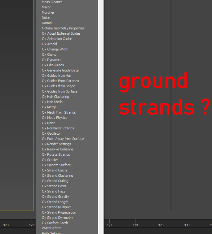

also ground strands missing in ver 7

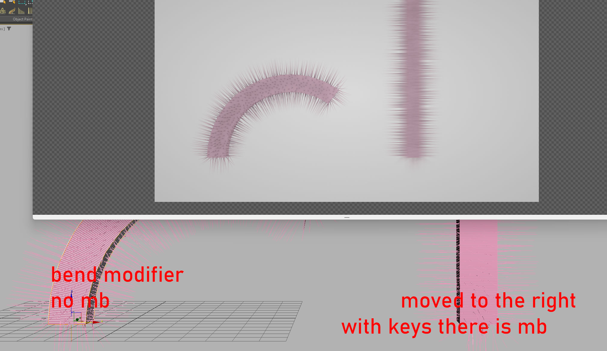

It seems that ornatrix and octane have no motion blur when 3ds max skin is animated using bones or mesh is bent using a bend modifier, for instance. If I key frame a mesh object with hair that moves to the side ornatrix does have motion blur.
So vertices are not sending velocity data info to ornatrix.
>bend+vs+transl.max (618496 bytes),
@Block Blast Instead of using an Octane Proxy for the animated character, try importing the animated mesh + Ornatrix hair directly into the scene without baking it into a proxy.
