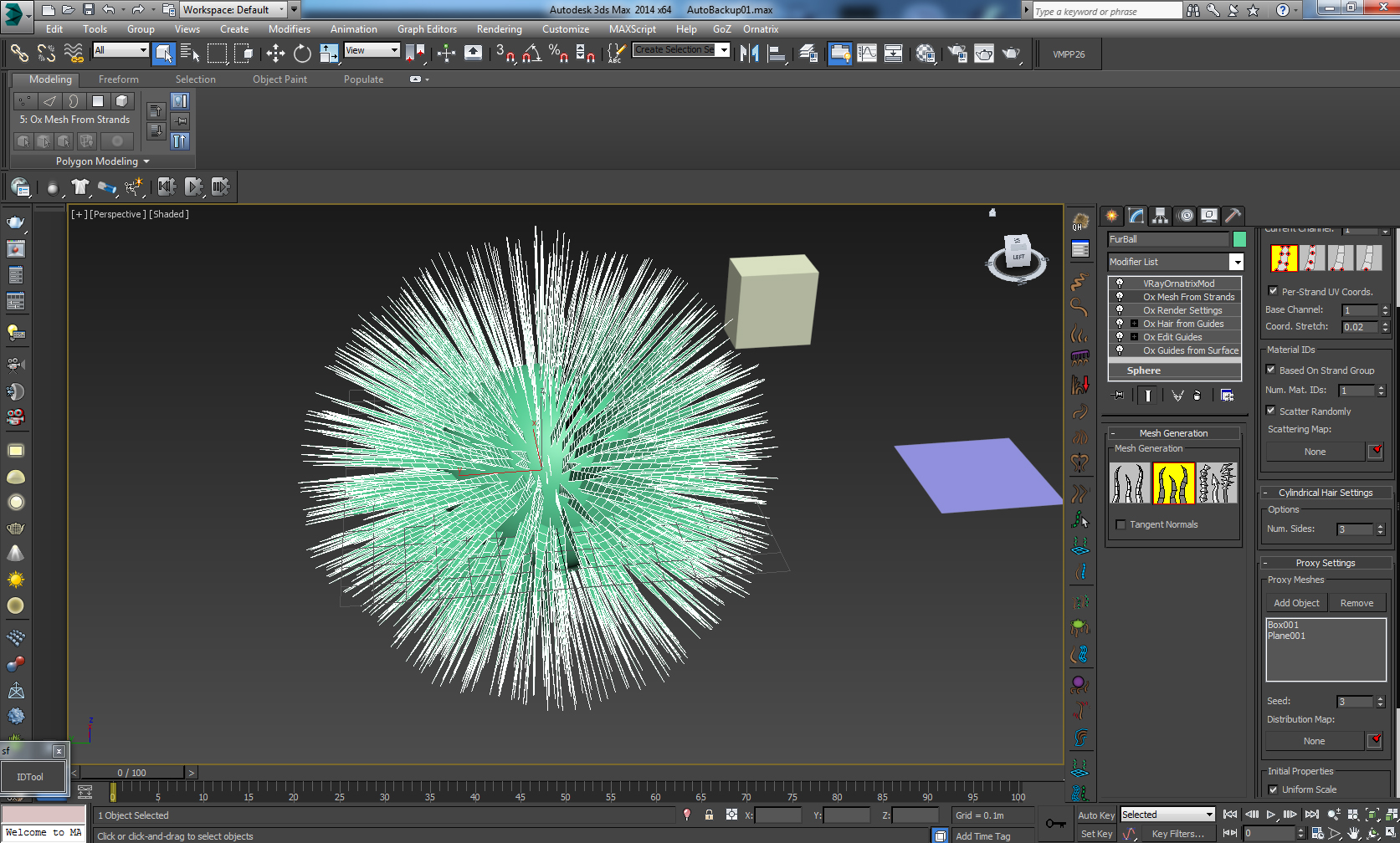

thx for your fast reply micheal . for the page you send for me i get this error . i guess i can use ox mesh from strands but when i put object in proxy part nothn not be changed not in wiew port and not in render ! where i do wrong ?
you can see my setting in image .

It looks like you need to choose the Proxy Geometry option at the top of Mesh from Strands. Right now you still have it as Billboard.
